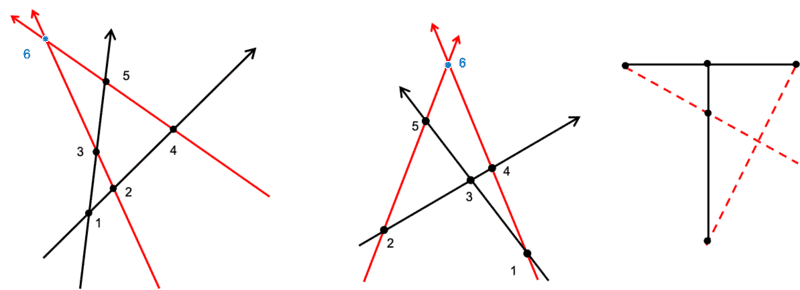

If my crystal ball is working right, exactly five intersection points are of one-way infinite trajectories into the past and the question focuses on the potential existence of a sixth intersection point somewhere in the infinite future. It's not just paths crossing. It's trajectories intersecting at events.
I think I can see my way clear toward a useful intuition from which the answer can be read off. The key is that it is not a problem in two dimensional geometry.

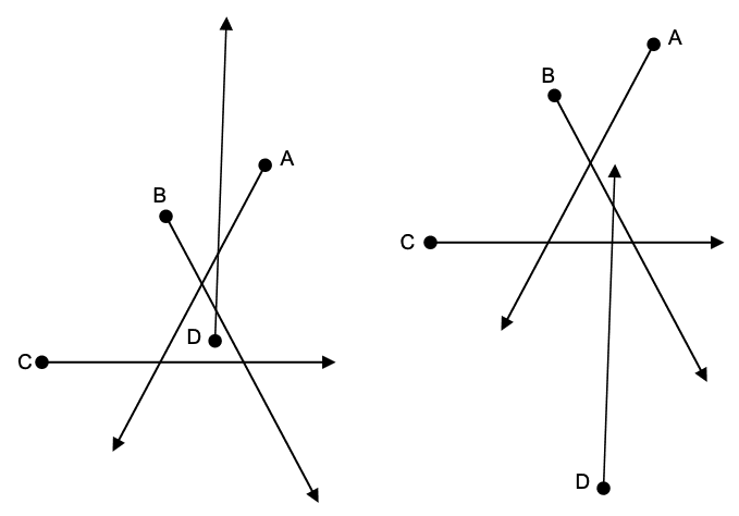

In my naive way of thinking this as a Euclidean plane geometry problem (the statement of the problem does mention a plane surface), I drew two snapshot pictures (see below). In each, the snails start at the circles and proceed with equal speeds. The arrowheads are their locations a very long time later when the snapshots were taken and the lengths of th arrows are equal.
The picture on the left shows that there is no crossing in the future. The picture on the right shows that merely by moving the starting position of one snail, there could be a sixth crossing. I can't believe it is that simple and I suspect that I missed something. That is why I asked if the paths are semi infinite.
Likes mfb, Delta2 and jbriggs444
Hmm if the problem was asking for the probability that the 6th crossing will happen given that 5 crossings have happen then is the answer easy? Is it something like 0.5?
@kuruman something doesn't look quite right with your diagrams, the snails can't move all with the same velocities or at least don't all start moving at the same time. Because for example if we mark X the point where A and C meet, then it is ##AX>CX## so if they started at the same time $$\frac{AX}{t}>\frac{CX}{t}\Rightarrow v_A>v_C$$. But the problem isn't clear if all the snails have the same speed and if they start at the same time.
Likes kuruman
Yes, you are correct. I didn't think the drawing through properly.

I think the drawing cases are still correct if we assume that the speeds are not all equal or that the snails don't start moving at the same time.

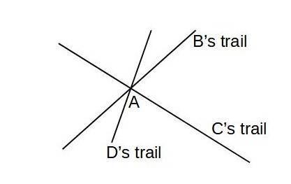

Encounter = two snails at the same place at the same time.
Call the snails A, B, C and D.
The 6 possible encounters are: AB, AC, AD, BC, BD and CD.
If there have been 5 encounters, one of the snails - say A - must have encountered the 3 others.
Now imagine being in A’s frame of reference. B, C and D (moving in straight lines) encounter A, though at different times. In A's frame, the trails of B, C, and D could look like this for example:
Clearly, B, C and D can’t encounter one another before or after they pass through A because their trails intersect only at A – their trails diverge as we move away from A.
The only way I can see to achieve more than 3 encounters is if the trails are colinear. But the question says the trails are 'random' and 'not parallel' – and surely colinear trails can't be considered random or parallel.
It’s really irritating me. Is there a mistake in the question or in my logic?

My take:
Changing the frame of reference effectively projects the paths of B, C and D onto a two dimensional coordinate system stationary relative to A. It is a rotation in three dimensions followed by a projection into two dimensions. This can make non-parallel paths parallel. In the same way the rotation/projection makes A's path into a point.
It is then possible for A, B and C to be colinear and for the encounter events to be overtake events.
Rather than rotate and project in this manner and thereby losing information, the approach that I recommend is the one that @willem2 alludes to. If snails A, B and C all encounter one another at distinct events, their trails define a two dimensional plane in three dimensional space-time. Since D encounters at least two of these, it must be coplanar. Use this plane.

Yes, that explains it! Many thanks.

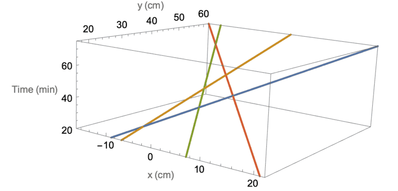

I think I have a handle on this problem. Here is the streamlined version omitting all the hair-tearing and going back and forth. First I will restate the question as I understand it.
Four snails, A, B, C and D are moving with constant velocities on an infinite plane. No paths are parallel to each other. There are 6 possible intersections, AB, BC, CD, DA, AC and AD and 6 possible encounters, i.e. 6 different times at which two snails are simultaneously at the intersection of their paths. According to the statement of the question "Five of the (4 × 3)/2 = 6 possible encounters have already occurred. Can we state with certainty that the sixth encounter will also occur?" The short answer to the question the way it's pharesed is "yes and no". The uncertainty that goes with "no" is that because I think that the question should have been phrased "Five and only five of the (4 × 3)/2 = 6 possible encounters have already occurred. Can we state with certainty that the sixth encounter will also occur?" Then the answer is "yes". I explain why and then provide a method for writing the snail path equations that provide the desired results.
Assumptions
1. We are given a drawing of five points on a plane representing the five encounter points that have already occurred.
2. The sixth intersection point to be found must occur at a later time than any of the five earlier points.
3. We are free to choose the speed and direction of motion of each snail on the path it follows.
The goal is to find the sixth encounter point and demonstrate that the time associated with it is greater than the previous five.
Reasoning
If one pair of the six is removed, the five pairs have two snails (letters) with three encounters and two snails with two encounters. For example, if CD is removed, then A and B appear three times and C and D appear twice.
Conclusion: In the given pattern of five encounters, one can always draw two intersecting lines with three points each. In the example above, one line could be labeled "A" and the other "B" with points (AB, AC, AD) and {BA, BC, BD) intersecting at AB=BA.
With this in mind, there are three possible patterns that can be produced. They resemble the letters X, T and V. These are shown below. In black are the two three-encounter path segments for easy recognition of V, X or T. Red lines indicate how to add the remaining two paths. Numbers indicate the temporal order of encounters and arrows indicate the direction of motion. It should be clear by inspection that no solution can be found for a "T" pattern without situating the sixth point between either arm and the foot of the "T". Thus, five given points in a "T" pattern imply that the sixth intersection point has already occurred. This violates Assumption 2.
Thus, the answer to the question posed by the problem is that
1. If there is no discernible V, X, or T pattern in the given five points, there can be no five encounters.
2. If there is a T pattern, the sixth crossing is one of the given five points.
3. If there is a V or X pattern one can construct a solution and find the sixth point as outlined below.
Construction
We will now see how to construct a path given a possible diagram. Construction means finding four speeds and six crossing times and verify the results. The given quantities are the five points in the plane and, clearly, there is no uniques solution. It is advisable to develop a method that will make the task easy to accomplish. I chose the first diagram on the left. Then
1. I drew a horizontal line below the diagram, called it the x-axis, and extended the four segments until they intersected it.
2. I labeled the intersection, left to right, A, B, C and D. Encounter 1 is AB, encounter 2 is AC and so on.
3. I measured the angles that the segments formed relative to the positive x-axis, ##0 \leq \theta_{\!}i \leq 2\pi## and the ditances ##x_{0,i}## from the leftmost intersection.
4. The guarantee for encounters is that all four ##y##-components be equal. I set the speed ##v_{\!A}=1## so that ##v_{y,i}=v_A\sin\theta_{\!A}##. I calculated the remaining three speeds using ##v_i=\dfrac{v_{\!A}\sin\theta_{\!A}}{\sin\theta_{i}}## and ##x##-components ##v_{x,i}=v_{\!A}\sin\theta_{\!A}\cot\theta_{i}##.
5. The positions as functions of time are $$\mathbf{r_i}=(x_{0,i}+v_{x,i}~t)\mathbf{\hat x}+v_{y,i}~t~\mathbf{\hat y}.$$6. To verify that the temporal sequence is correct, the encounter times are found from ##~~x_{0,i}+v_{x,i}~t_{ij}=x_{0,j}+v_{x,j}~t_{ij}.##
The figure below shows a 3d plot of the result. The third axis is time. I used the typical snail speed of 1 cm/min for ##v_{\!A}##.

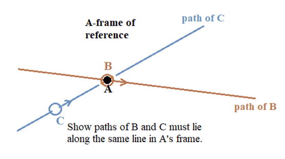

Unless I'm overlooking something, I think @Steve4Physics has a nice approach in post #21.
Given that the 5 encounters AB, AC, AD, BC, and BD occur, we want to prove that the sixth encounter CD must occur. Steve4Physics has essentially shown that in the frame of reference of snail A, snails B, C, and D must move along the same straight line. To recap the reasoning, suppose that in the A-frame, B and C do not move along the same straight line:
The black dot is snail A at rest in this frame, the brown circle is B, and the blue circle is C. B encounters A at the instant shown. C cannot also encounter A at this instant since that would imply that A, B, and C occupy the same spatial point in the original reference frame at this instant. But we are given that no more than two snail paths can cross at any one point of the original frame. It should then be clear that for any speeds of B and C in the picture above, B and C can never encounter each other if they are moving along different lines in the A-frame. We conclude that the only way that B and C can encounter each other is for B and C to move along the same straight line in the A-frame. The same argument holds for B and D. Thus, all three snails B, C, and D move along the same line in the A-frame. (They don’t necessarily move in the same direction along the line.)
@jbriggs444 already pointed out in post #26 that nonparallel paths in the original frame can become parallel in the A-frame. We see that the nonparallel paths of B, C, and D in the original frame become the same line in the A-frame.
We can also conclude that in the A-frame the velocity vectors of B, C, and D must all be different. If two of the snails had the same velocity in the A-frame, then the two snails would have the same velocity in the original frame. This would imply parallel paths for these two snails in the original frame. However, the problem statement assumes that none of the paths are parallel in the original frame.
So, in the A-frame, snails B, C, and D move along the same straight line with different velocities. In particular, C and D move along the same line with different velocities. Hence C and D must have an encounter, which is what we wanted to show. We conclude that 5 encounters imply 6 encounters.
