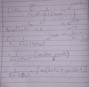

Fourier series expansion of a signal f(t) is given as
f(t) = summation (n = -inf to n = +inf) [3/(4+(3n pi)2) ) * e j pi n t
A term in expansion is A0cos(6 pi )
find the value of A0
Repeat above question for A0 sin (6 pi t)
Fourier expansion is summation n = -inf to +inf Cn ejwnt
where Cn is Integration over T0 x(t) e-jwnt dt
In book they've said Cn is right.
But then they say an is 2 times real part of Cn
and have done an = 6/[4 + (18 pi)2
For third part they've put A0sin (6 pi t) = bn sin (n w t)
and for n = 6, this is zero.
I didn't understand this part. Why did they multiply it by 2 first and then how did it become zero in the second.
I understand that sin ( 6 pi) is zero but how can sin ( 6 pi t) be zero? Wouldn't this vary as 't' varies?[/B]
The coefficients of [itex]\cos n\pi t[/itex] and [itex]\sin n\pi t[/itex] come not just from [itex]c_n[/itex], but also [itex]c_{-n}[/itex]: [tex]
c_ne^{i n\pi t} + c_{-n}e^{-in\pi t} = (c_n + c_{-n})\cos n\pi t + i(c_n - c_{-n})\sin n\pi t[/tex]
Likes jaus tail
Oh yeah. Thanks. I didn't think about C-n.
