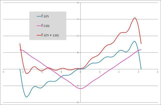

I've been piling error on top of error in this exercise (*) as well (nobody is perfect), but I convinced myself you are perfectly correct (I cheated by finding the series in a textbook example). Even made a plot for the first eight terms:
Nice to see a triangle (no discontinuities) is easier to reproduce than a sawtooth !
Now I'm not sure what you mean with "when i make x=π/4 i don't get 1 at n=0 like in the sequence"
You make x a certain value and you add a good number of terms. At n = 0 you are supposed to get only the π/4 and the summation for the sines and cosines start at n = 1.
Going back to your original exercise: to show π/4 = 1 - 1/3 + 1/5 you need a value for x that makes the cosine terms to go away. In fact the plot above makes the choice obvious ! So sorry for spoiling :wink: ...
