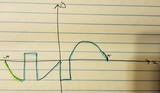

Trying to understand the requirements for a function to be represented by a Fourier series

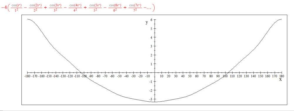

Hi,
A function which could be represented using Fourier series should be periodic and bounded. I'd say that the function should also integrate to zero over its period ignoring the DC component.
For many functions area from -π to 0 cancels out the area from 0 to π. For example, Fourier series representation #1 below approximates such a function.
For some functions area from -π to -π/2 cancels out area from -π/2 to 0, and then area from 0 to π/2 gets canceled by the area from π/2 to π. For example, Fourier series representation #2 below approximates such a function.
I'm not sure if the function needs to integrate to zero following these two patterns, or it should just amount to zero without actually following any pattern of area cancellation. Could you please let me know if I have it right?
Could you represent a function something like this using Fourier series? I'm just trying to get general concept about Fourier series right. Thank you for your help.
That's a way of saying twice the same -- the DC component IS (proportional to) the integral over the period. And a Fourier series starts with the coefficient for ##\cos(0)## -- a constant.
[edit] and, to answer your question: yes, your slightly pathological function can also be represented by a Fourier seeries
Likes PainterGuy
Thank you!
But doesn't there exist a periodic function(s) which doesn't integrate to zero over its period? Thanks a lot for your help.
You can add a constant to any periodic function and it remains periodic. And the only term that changes in the Fourier series is the ##a_0## term.

The original function doesn't need to be periodic. The more general application is that you want to represent the function on an interval [a, b], and you don't care about outside the interval.
The range of functions which can be approximated by a Fourier series on an interval is pretty broad. You can for instance have a jump discontinuity as in a step function. The series doesn't converge to f(x) at the point of discontinuity (for instance if you have a jump from 0 to 1 at x0, the series may converge to 1/2).
I don't recall the precise conditions for pointwise convergence of a Fourier series, but they're mentioned in this thread:

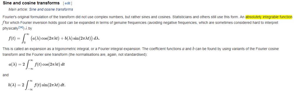

Question 2:
I prefer trigonometric form of Fourier transform over the exponential form because it's easier to think of it as an extension of trigonometric form Fourier series. Given below are two excerpts about trigonometric form of Fourier transform.
Excerpt #1:
246367
Excerpt #2:
246368
Source: https://en.wikipedia.org/wiki/Fourier_transform#Sine_and_cosine_transforms
The given below Fourier transform for a unit pulse is found using exponential form of Fourier transform. Is it possible to find it using trigonometric form of Fourier transform? I'm sorry I didn't do it but it looks like it's not possible. Although considering the sufficient conditions given in excerpt #1 above, the f(t) is a piecewise continuous function.
246369
Thank you for your help and time.

In Question 2 you're looking at the continuous Fourier Transform, which is generalized from the series version. The series version as I said is appropriate for periodic functions or functions which are defined only over a finite interval. The continuous transform is defined for a different class of functions which are given in your excerpt.
They're not quite the same though obviously there's a connection.
Anyway in answer to your question, your ##f(t)## is an even function. That causes the integral for ##b(\lambda)## to be 0 for all ##\lambda##. The integral for ##a(\lambda)## just becomes an integral of ##\cos(2\pi\lambda t)## from ##-b## to ##+b## which gives the expression you're looking for.

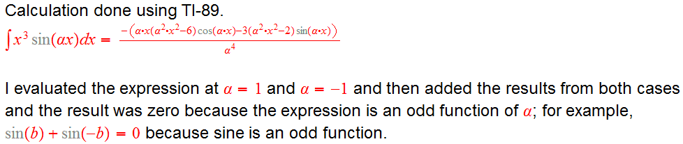

Here are the integrals.
$$\int_{-\infty}^\infty f(t) \cos(2\pi \lambda t) dt = \int_{-b}^b \cos(2\pi \lambda t) dt \\
= \frac {1}{2\pi\lambda} \left [\sin(2\pi\lambda b) - \sin(-2\pi\lambda b) \right ] \\
= \frac {1}{2\pi\lambda} \left [\sin(2\pi\lambda b) + \sin(2\pi\lambda b) \right ] \\
= \frac {2 \sin(2 \pi \lambda b)} {2 \pi \lambda} \\
= \frac {2 \sin(\omega b)} {\omega} \text{ where } \omega = 2\pi\lambda$$
$$\int_{-\infty}^\infty f(t) \sin(2\pi \lambda t) dt = \int_{-b}^b \sin(2\pi \lambda t) dt \\
= \frac {1}{2\pi\lambda} \left [-\cos(2\pi\lambda b) + \cos(-2\pi\lambda b) \right ] \\
= \frac {1}{2\pi\lambda} \left [-\cos(2\pi\lambda b) + \cos(2\pi\lambda b) \right ] = 0 $$
Likes PainterGuy
246532

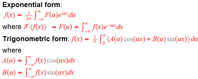

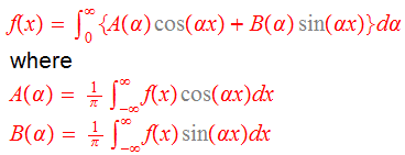

In your calculation, you used formulae from Excerpt #2. You didn't use the factor "2" in front of integral.
I did the calculation using formulae from Excerpt #1 and didn't use the factor of (1/π). I reached the same solution as you and apparently this is the correct solution. Then, why would Excerpt #1 and #2 have those factors?
246533
The most used form of Fourier transform is exponential form given as:
246534
By comparing trigonometric form and exponential form, we can see that A(α)=F(α).
Both A(α) and F(α) give us the magnitudes of involved frequencies and it implicitly means that if you add all the frequencies with given magnitudes, you would get f(x) back.
On the other hand, trigonometric form does convey the information by explicitly stating how to get f(x) back as shown below.
246535
I was trying to find that why the exponential form of Fourier transform is more popular compared to its trigonometric equivalent. I was able to find an answer, https://math.stackexchange.com/ques...er-series-versus-trigonometric-fourier-series, which gives the reasons in terms of exponential form of Fourier series and trigonometric form of Fourier series. It has more to do with cleanliness, compactness, and easy manipulation of exponential form compared to the trigonometric and it wouldn't be wrong to say that both are equally applicable mathematically.
Thanks a lot for your help and time!

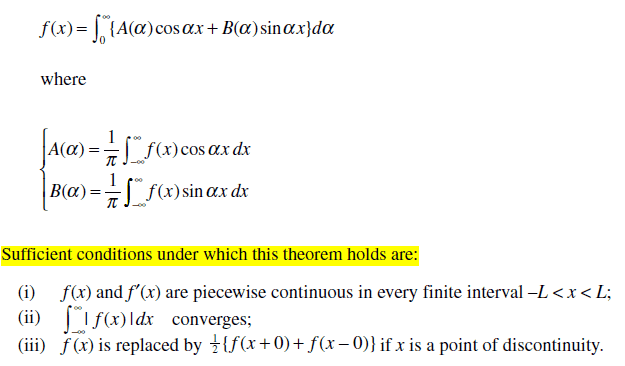

Hi
Check the dirichlet conditions
Any function that satisfies these, has a Fourier series rep.

Thanks. I agree with you.

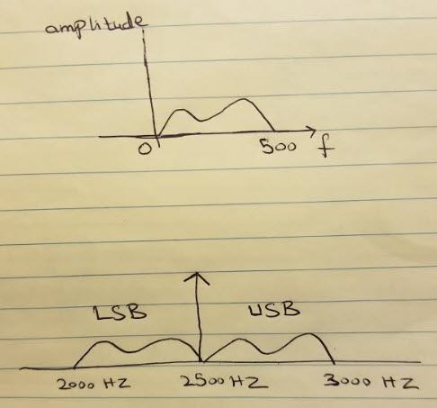

This is another related question. Suppose that the frequency spectrum of a modulating signal is found using the trigonometric form of Fourier transform, and, say, this spectrum extends from 0 Hz to 500 Hz. Now let's suppose that frequency of carrier wave is 2500 Hz. As there are no negative frequencies in the modulating signal therefore only upper side band (USB) should be generated and there should be no lower side band (LSB). But I have never seen any picture of a spectrum of modulated signal, such as AM, where LSB is missing; mostly modulated signal appears like this. Why isn't it possible to avoid LSB when using only positive frequencies, or is it just me?
That's incorrect. Having only one frequency at baseband doesn't mean you'll have only one frequency after mixing up. Let's analyze a simple amplitude modulated carrier wave.
Let's say the carrier frequency is ##\Omega## (I'm going to use angular frequencies such as ##\Omega = 2\pi F## to avoid writing lots of ##2 \pi's##) so the carrier wave is ##\sin(\Omega t)##.
Now we modulate it at frequency ##\omega## so our signal is ##s(t) = \sin(\omega t) \sin(\Omega t)##
Let's derive a little trig identity that we'll need. Consider ##\cos(x + y) = \cos(x) \cos(y) - \sin(x) \sin(y)## and ##\cos(x - y) = \cos(x) \cos(y) + \sin(x) \sin(y)##. So ##\cos(x - y) - \cos(x + y) = 2\sin(x) \sin(y)##
Then ##s(t) = (1/2) \left [ \cos(\Omega - \omega)t - \cos(\Omega + \omega)t \right ]##
Mixing (multiplying by a sinusoid) produces both sum and difference frequencies, and removing one of those frequencies requires an extra filtering step.

Thank you for correcting me.
For some reason I was wrongly under the impression that lower side band is a result of using negative frequencies of the exponential form.

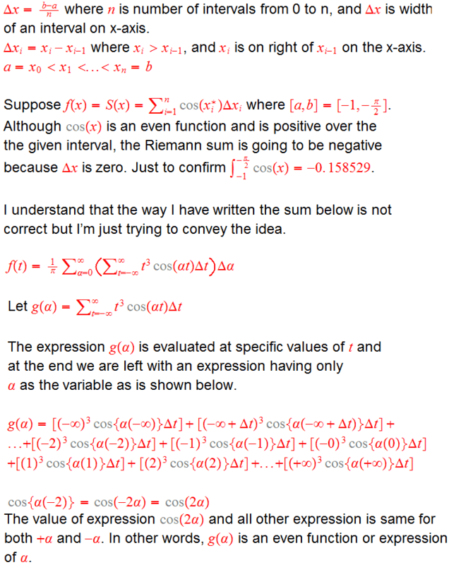

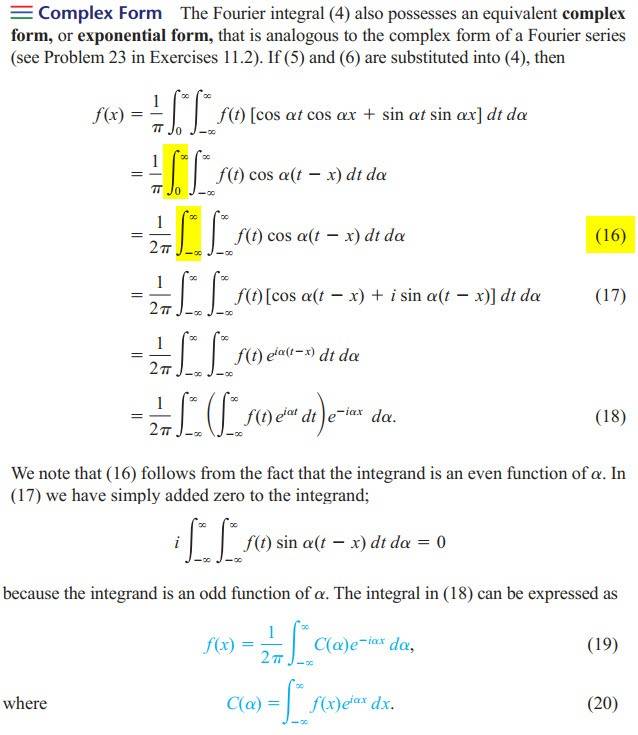

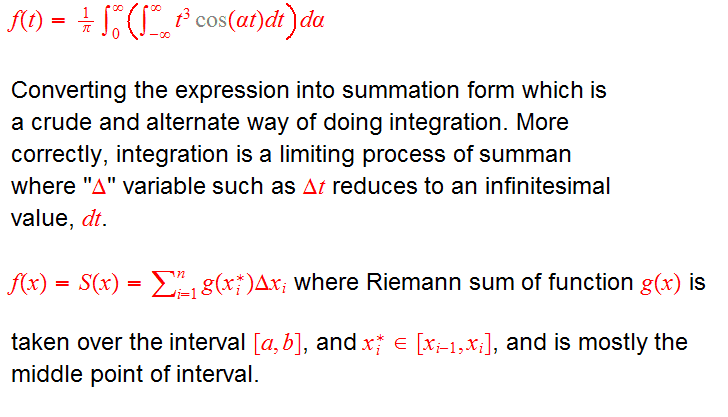

Please have a look on the attachment, fourier_expo1.
I'm not sure how the author gets to step 16. I tried it but "-" sign stands in my way as shown below.
Thank you for your help and time!

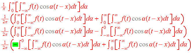

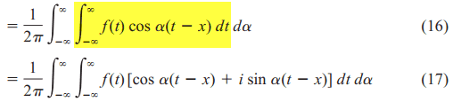

The author says the integrand is an even function of ##\alpha##, so ##\int_{-\infty}^0 d\alpha## should be the same as ##\int_{0}^{\infty} d\alpha##. You have a sign error in your third line.
Let's define ##g(\alpha) = \int_{-\infty}^{\infty} f(t) \cos \alpha(t - x) dt##. Then ##g(-\alpha) = g(\alpha)## because ##\cos## is even, i.e., ##\cos [-\alpha(t - x)] = \cos \alpha(t - x)##.
So ##\int_{0}^{\infty} g(\alpha) d\alpha## = ##\int_{0}^{\infty} g(-\alpha) d\alpha## = -##\int_{0}^{-\infty} g(\beta) d\beta## where ##\beta = -\alpha, d\beta = -d\alpha##
Thus ##\int_{0}^{\infty} g(\alpha) d\alpha## = ##\int_{-\infty}^0 g(\beta) d\beta##
Intuitively, if you have an even function, so the graph to the left of the y-axis is the mirror image of the graph to the right of the y-axis, then the area under the left half should be the same as the area under the right half.
Likes PainterGuy

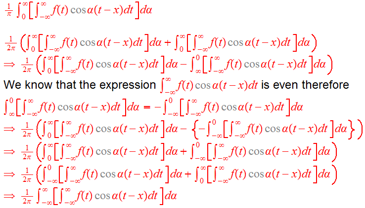

I did read that statement about the integrand being an even function. In case of an even function, Fourier sine term is zero, and in case of odd function the cosine term is zero.
I understand what you said about integral of an even function in general but in this specific case I'm confused.
I believe the author is saying, like you, that the part in yellow results in an even function of α.
RPinPA said:
Let's define g(α)=∫∞−∞f(t)cosα(t−x)dtg(α)=∫−∞∞f(t)cos⁡α(t−x)dtg(\alpha) = \int_{-\infty}^{\infty} f(t) \cos \alpha(t - x) dt. Then g(−α)=g(α)g(−α)=g(α)g(-\alpha) = g(\alpha) because coscos\cos is even, i.e., cos[−α(t−x)]=cosα(t−x)cos⁡[−α(t−x)]=cos⁡α(t−x)\cos [-\alpha(t - x)] = \cos \alpha(t - x).
I agree that cosα(t-x) is an even function but the expression also involves f(t) and I don't think we really know if it's even or odd or both. Also, g(α) is an integral expression where integration variable is time and not α. My confusion stems from this point.
The product of two even functions is an even function. The product of two odd functions is an even function. The product of an even function and an odd function is an odd function.
For example, in this thread, https://www.physicsforums.com/threads/ambiguous-results-for-two-fourier-transform-techniques.974660/ , Fourier transform of f(t)=a.e^(-bt).u(t) was found to be a/(b+jω) or a/(b+jα); u(t) is a step function. The plot shown below is for a=b=1.
Source: http://pages.jh.edu/~signals/spectra/spectra.html
The magnitude of 1/(1+jα) is an even function but the phase is an odd expression. This, 1/(1+jα), function is same as g(α) or equivalent to the expression in yellow highlight.
So is g(α) or g(ω) an even function in this case?
Where am I going wrong? Could you please guide me?
Which is independent of ##\alpha##, and therefore is unaffected when you change ##\alpha## to ##-\alpha##. When you make that change, the equation for ##g(\alpha)## is completely unchanged and therefore results in exactly the same function. The question of whether ##g(\alpha)## is even is in terms of that change, relative to an integral over ##\alpha##. The only question is what happens to it when you change ##\alpha## to ##-\alpha##.
##t## is a dummy variable in ##g(\alpha)##. After you perform the integration, there is no ##t## there, which is why you can write ##g## as a function of ##\alpha## with no dependence on ##t##. There is no ##t##. You could call it ##x##. You could call it ##s##. You could call it anything you want, but whatever you call it, it no longer appears after you do the integration.
Likes PainterGuy
Here is a simpler example of what's happening here.
Define ##g(\alpha) = \int_1^2 (\alpha t)^2 dt##. That may look like a function of ##t## to you, but it's not. ##t## is a dummy variable which does not exist outside the integral sign. We can explicitly calculate the value of ##g(\alpha)## by doing the integral.
##g(\alpha) = \alpha^2 \int_1^2 t^2 dt = \alpha^2 (2^2 - 1^3) = 3\alpha^2## and now you can see explicitly that (1) ##g## does not depend on ##t## and (2) ##g## is an even function of ##\alpha## and (3) it doesn't make sense to ask whether ##g## is an even function of ##t## or an odd function of ##t## because it is not a function of ##t## at all.
That's happening in your expression. The integral of ##g(\alpha)## when ##\alpha## goes from ##0## to ##\infty## is exactly the same as the integral of ##g(\alpha)## when ##\alpha## goes from ##-\infty## to ##0## because ##g(\alpha)## is a function of ##\alpha## which is unchanged when ##\alpha## is changed to ##-\alpha##. No matter what ##f(t)## is, ##g(\alpha)## does not contain a ##t##.
But even if it did contain other variables, the only thing that matters in the question of whether ##g## is even with respect to ##\alpha## is what happens when you change ##\alpha## to ##-\alpha##.
Likes PainterGuy

The following is a note to myself or for someone else like me who stumble upon this thread.
The author said, "We note that (16) follows from the fact that the integrand is an even function of a. In
(17) we have simply added zero to the integrand; ..., because the integrand is an odd function of a.

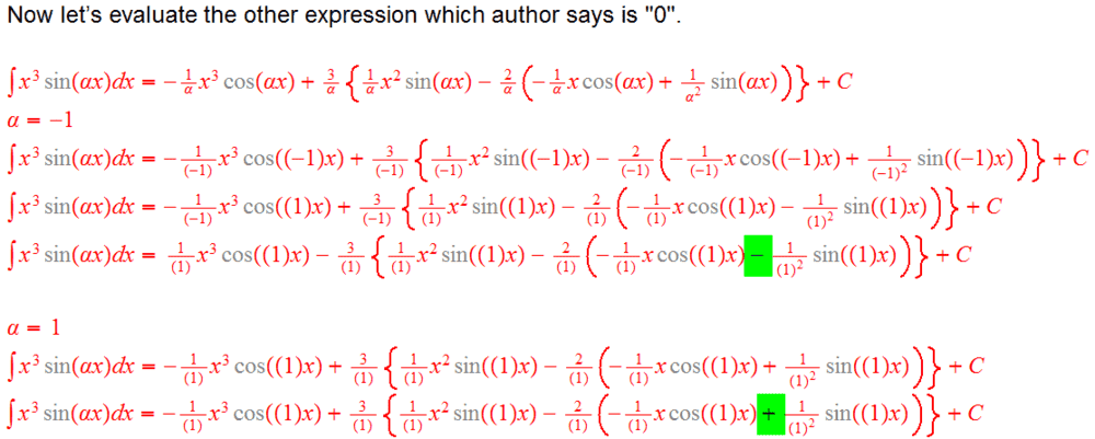

Now let's focus on this part where the author said, "In (17) we have simply added zero to the integrand; ..., because the integrand is an odd function of a."
In the following calculation everything seems to cancel out but those differing "+" and "-" signs wouldn't let the expression cancel completely. Both signs should have been either "+" or "-". I wasn't able to track the error. The integral was evaluated using Symbolab.
I evaluated the same expression using TI-89 and the expression does cancel out to give "0" as said by the author. The TI-89 calculation is also shown.
This post continues into the next posting.
