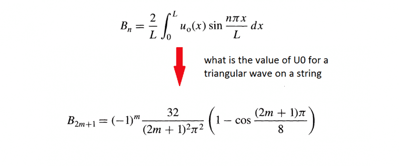

A string of length L =8 is fixed at both ends. It is given a small triangular displacement and released from rest at t=0. Find out Fourier coefficient Bn.
what should i use for U0(x) ?

ax from 0 to L/2 and x(1-x) from L/2 to L . Oops :nb), I'm not supposed/allowed to give direct answers !

First, you need to know what the "small" displacement is. Let's say you lift the center by an amount ##h##, so the center of the string is at ##(\frac L 2,h)##. Now just find the equation of the two straight line segments forming the triangular displacement. Also, I would ignore BvU's answer which is a) discontinuous and b) partially parabolic.

No, it was just a typo. I (of course) meant
ax from 0 to L/2 and a(L-x) from L/2 to L
And for the Fourier coefficient calculation it really doesn't matter how big a (or h) is.
