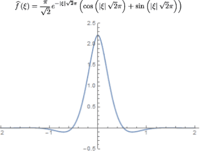

Calculate ##F(\frac 1 {1+x^4})##.
##\hat f (ξ) = \int_ℝ \frac 1 {1+x^4} e^{-2\pi i ξ x} dx##
and Residue Theorem
I know the function has to be real and even because ##\frac 1 {1+x^4}## is real and even, but I can't work out the calculations:
I will start to evaluate for ##ξ > 0## and then exploit symmetry to extend the result to ##ξ < 0##
for ##ξ > 0## I have ## -2\pi i ξ x < 0## so
$$\hat f (ξ) = \int_ℝ \frac 1 {1+x^4} e^{-2\pi i ξ x} dx = 2 \pi i [ Res(..., e^{\frac {-\pi i} 4}) + Res(..., e^{\frac {-3 \pi i} 4}) ] = 2 \pi i \left[ \left( \frac {e^{-2 \pi i x ξ}} {4x^3} \right)_{x = e^{\frac {-\pi i} 4}} + \left( \frac {e^{-2 \pi i x ξ}} {4x^3} \right)_{x = e^{\frac {- 3\pi i} 4}} \right]$$
I've tried everything but I can't figure out a single way to make this a Real function... Even Wolfram Alpha can't do it. Also google doesn't help me :( :(
Here's the smooth result from my book:

If
##r_1 = \frac{1}{\sqrt{2}} (1+i), r_2 = \frac{1}{\sqrt{2}} (-1+i), r_3 = \frac{1}{\sqrt{2}} (1-i), r_4 = \frac{1}{\sqrt{2}} (-1-i)## we have
$$z^4+1 = (z-r_1)(z-r_2)(z-r_3)(z-r_4)$$ Thus, with ##f(z) = \exp(-2 \pi i z \xi)/(z^4+1)## we have
$$\text{res}(f)|_{z = r_3} = \frac{\exp(-2 \pi i r_3 \xi)}{(r_3-r_1)(r_3-r_2)(r_3-r_4)}$$ etc. Theoretically, this should match the expressions you gave.
BTW: for ##\xi > 0##, you complete clockwise in the lower ##z##-plane, so you need ##-2 \pi i## instead of ##+2 \pi i## in front.
When I do the computations using Maple, I get exactly same result as your book's.

The best way is to take it slowly, in pieces, then put things together after the parts are as simple as possible.
Let's use the notation ##y## instead of ##\xi##, and let ##c = 1/\sqrt{2}##. For real ##\theta## we have ##1/\exp(-i \theta) = \exp(i \theta),## obtained by multiplying both the numerator and denominator by ##\exp(i \theta).##
(1) For ## r_1 =\exp(-i \pi/4) = c(1-i)## we have ##1/(4 r_1^3) = 1/(4 \exp(-i \pi 3/4) )= (1/4) \exp(i \pi 3/4) = (c/4) (-1+i).## We also have
$$\begin{array}{rl}\exp(-2 i \pi y r_1) &=& \exp(-i 2 \pi y c(1-i)) = \exp((-i)^2 2 \pi c y) \exp( - i 2 \pi y c) \\
&=& E (C-iS)
\end{array}$$
where ##E = e^{-2 \pi c y}##, ##C = \cos(2 \pi c y)## and ##S = \sin(2 \pi c y).## Thus
$$\text{res}(f)|_{z=r_1} = T_1 = (c/4) (-1+i) E (C-iS)$$
(2) For ##r_2 = \exp(-i 3 \pi/4) = c(-1-i)## we have ##1/(4 r_2^3) = 1/(4 \exp(-i \pi 9/4) )= (1/4) \exp(i \pi 9/4)= (1/4)\exp(i \pi/4) = (c/4)(1+i).## We also have
$$\begin{array}{rl} \exp(-2 i \pi y r_2) &=& \exp(-i 2 \pi y c(-1-i)) = \exp((-1)^2 2 \pi c y) \exp(i 2 \pi c y)\\
&=& E (C+iS) \end{array}$$ Thus
$$\text{res}(f)|_{z=r_2} = T_2 = (c/4)(1+i) E (C+IS)$$
The sum of the residues is ##T_1 + T_2 = (i c/2) E (C+S),## so ##-2 \pi i (T_1+T_2) = \pi c E (C+S)## is real.
I could not see where you made your errors because you did not lay out the work step-by-step in modest chunks that were each easy to check.
Likes dRic2
Thank you very much! Maybe my mistake was keeping also the denominator in exponential form because I know the result I got is Real (I checked it with wolfram alpha), but I can't simplify it. I will try out your methods! Thanks again
