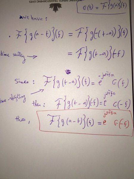

Can you check the workout i did in the picture below ?

The time scaling property states:
$$\mathcal{F} \{g(\alpha x) \} = \frac{1}{|\alpha|} \hat G \left( \frac{f}{\alpha} \right)$$
You know ##\mathcal{F} \{g(t) \} = \hat G(f)## and ##g(a - t) = g((-1) (t - a))##.
Let ## u = t - a##. Then ##g((-1) (t - a)) = g((-1)u) = g(\alpha u)## with ##\alpha = -1##.
Then you know ##\mathcal{F} \{g(\alpha u) \} = \frac{1}{|\alpha|} \hat G (\frac{f}{\alpha}) = \hat G (-f)##.
This amounts to saying: Since you know ##\mathcal{F} \{g(t) \} = \hat G(f)##, then you can simply apply a negative sign to the argument and get ##\mathcal{F} \{ g(a - t) \}##.

There has to be an exponential factor . Did you check my solution ?
The solution is fine, I thought it would be insightful to elaborate on the time-reversal property where ##\alpha = -1##.
