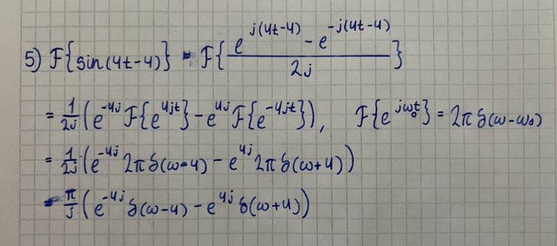

Find the Fourier transform of sin(4t-4)
Regular Fourier transforms
This is my attempt at a solution. I have used Eulers formula to rewrite the sine function and then used the Fourier transform of complex exponentials. My solution is not correct and I don't understand if I have approached this problem correctly. Please help.
$$ \mathcal{F}\{\sin (4t-4) \} = \frac{1}{2j} \mathcal{F} \{ e^{j(4t-4)} - e^{-j(4t-4)} \} $$
$$ \frac{1}{2j}(e^{-4j} \mathcal{F}\{ e^{4jt}\} - e^{4j} \mathcal{F}\{ e^{-4jt} \}) = \frac{1}{2j}(e^{-4j} 2 \pi \delta(\omega - 4)-e^{4j} 2 \pi \delta(\omega + 4))$$
$$ \mathcal{F(\omega)} = \frac{\pi}{j}(e^{-4j} \delta(\omega - 4) - e^{4j}\delta(\omega + 4)) $$

Well, you are not very far off when compared to this one
Perhaps a factor ##\sqrt{2\pi}## can be found somewhere ?

I tried inputting this solution but it was incorrect. I can't see where a factor of ##\sqrt{2\pi}## would come from?
I figured it out, I made a mistake when I assumed that the time shift was ##(t-4)##, but the function can be rewritten as ##\sin(4t-4) = \sin(4(t-1))##, with time shift ##(t-1)##. The transform then becomes ##\frac{\pi}{j}e^{-j \omega}(\delta(\omega -4) - \delta(\omega + 4))##, which is correct.
