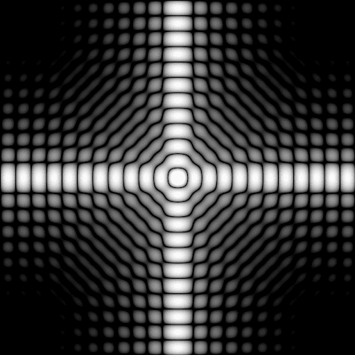

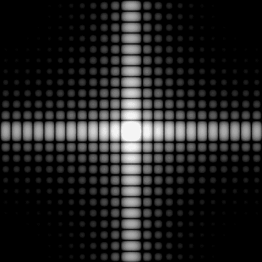

So this is getting trickier. I have attached two files: One is the Fourier transform of just a "square", and the other a "square annulus". I did these two numerically.

Sorry, you are right, I flubbed the function f. It is a sum of four line segments, each of finite length.
[tex]f(x,y)=a[\delta(x+x_0)+\delta(x-x_0)]rect\left(\frac{y}{2y_0}\right)+a[\delta(y+y_0)+\delta(y-y_0)]rect\left(\frac{x}{2x_0}\right).[/tex]
Now do the x transform of f(x,y), then do the y transform of the result. You will get the sum of two terms, each of which is a product of a sinc times a cosine.
Sorry again to lead you astray.
