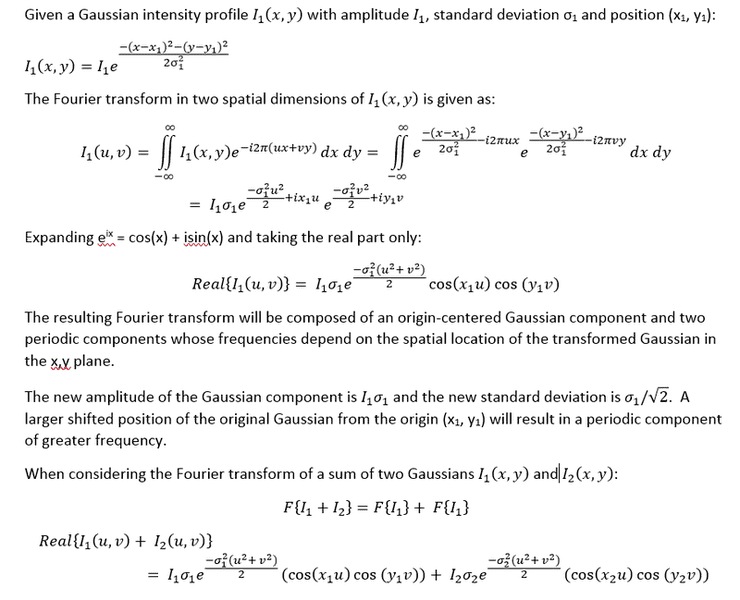

I mean convolved with. I ended up working it out, my first assumption was correct I just did the work wrong. I was wondering if anyone can take a look at my result
