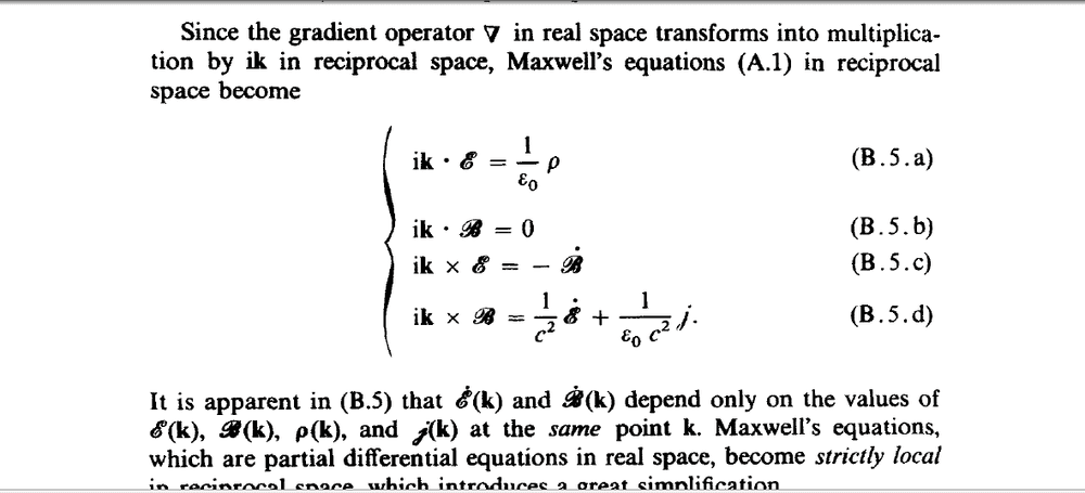

In summary, the book writes the Maxwell equations in reciprocal space, and then substitutes any spatial derivative with the derivative in i-space.

Hello, I am unfamiliar with Maxwell's equations' Fourier transform. Are there any materials talking about it?
Sorry, I am in China and cannot visit google. Besides, I don't mean solving equations using Fourier transform, but the Maxwell's equations in reciprocal(momentum) space. Better some textbooks treat it.

Thanks. I don't follow what this article said well. The books talk about it as below:
Well, ok. What the book obviously does is to write the Maxwell equations,
$$\vec{\nabla} \cdot \vec{E}=\rho/\epsilon_0, \quad \vec{\nabla} \cdot \vec{B}=0, \quad \vec{\nabla} \times \vec{E}=-\dot{\vec{B}}, \quad \vec{\nabla} \times \vec{B}=\frac{1}{c^2} \dot{\vec{E}} + \mu_0 \vec{j}.$$
Note that in the somwhat confusing SI units ##c^2=1/(\epsilon_0 \mu_0)##.
Now they go to Fourier space wrt. to the spatial argument, i.e., they write
$$\vec{E}(t,\vec{x})=\int_{\mathbb{R}^3} \mathrm{d}^3 k \frac{1}{(2 \pi)^3} \exp(\mathrm{i} \vec{x} \cdot \vec{k}) \vec{\mathcal{E}}(t,\vec{k})$$
and analogously for all the other fields involved.
Then any spatial derivative is simply substituted by ##\vec{\nabla} \rightarrow \mathrm{i} \vec{k}##. Then immideately get the equations you copied from the textbook.

Thanks. This is what I need. Is it discussed in any books?
