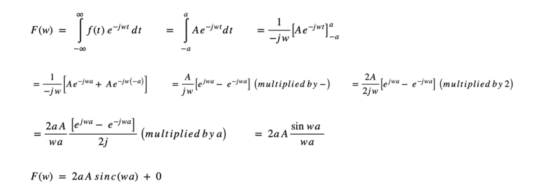

Here is my answer
Wolfram says your final result is correct, hold on while I check your in between steps.
one thing that I am confused, where can I use 2a as width here? I guess width represents time pr frequency, right?
Yes the in between steps seem correct to me.
I don't understand your confusion.
2a is the width of the pulse in the time domain, in the frequency domain it seems to have infinite width,
but
this is typical happening with Fourier transform, a narrow function in time domain has a wide Fourier transform in the frequency domain, and a wide function in the frequency domain has a narrow inverse Fourier transform in the time domain.

I mean where can I put 2a in my calculation? How can I applied in that math formula? or we don t need to put 2a in that calculation? In my answer, I only used A as height
You have 2a in your final result for F(w) but that doesn't mean that it is the width of F(w) in the frequency domain.
What math formula do you mean? The starting integral of Fourier transform?
The width appears through the bounds of the integration. As you can see, your final result depends of the width of the pulse.
Likes Delta2
Yes well it depends what equivalent expression for F(w) you want to make. If you want to express it in terms of the ##sinc x## function then you must put the 2a there.

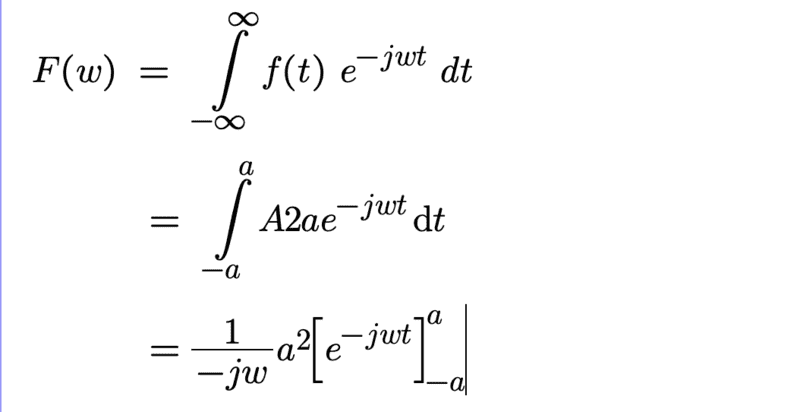

where should I put 2a? Did you mean like the picture below?
Well, theoretically speaking you can put 2a inside your calculation steps, in an infinite number of ways, for example you can multiply by the term ##\frac{2a\cos(2a)\sin(2a)}{2a\cos(2a)\sin(2a)}## which is one and nothing changes, but the point is to put it when it has some utility.
Wolfram gives the answer as $$F(w)=2A\frac{\sin(aw)}{w}$$ but if we want to express this in terms of the ##sinc(aw)=\frac{\sin(aw)}{aw}## then we have to multiply and divide by ##a##, pretty much like you did.
##SincX## function is like a basis function for Fourier transforms, many Fourier transforms can be expressed in terms of the sinc function.
No you can't put it there like this because you change the function of Fourier transform , you will compute the Fourier transform of the function ##g(t)=2aA ## ,##t\in [-a,a]##, but the problem asks for the Fourier transform of ##f(t)=A##...

basically, I don't need to multiply a in my calculation based on Wolfram, right? what does a refer to?
Likes Delta2
a is the half width of the pulse, and it is also in the boundaries of the integral of the Fourier transform.
can I just remove a in my answer? so my answer will be exactly like Wolfram
yes you can but should NOT remove it from inside the ##\sin(aw)##.

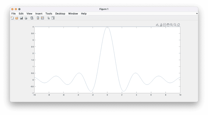

I got it, thank you very much. Then, if I am asked to draw the wave of F(w), can I use Matlab? I tried them. Here they are. Do you think I got it right? I am still not sure how to convert the calculation result in Matlab.

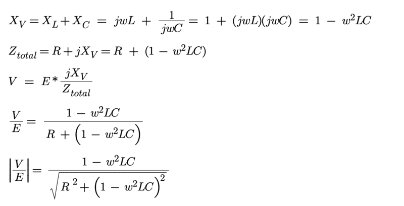

The first screenshot might be the graph of ##\frac{\sin(aw)}{w}## for some ##a##, but I don't know about the second screenshot...Calculations for impedance of an RLC circuit? what those have to do here?
