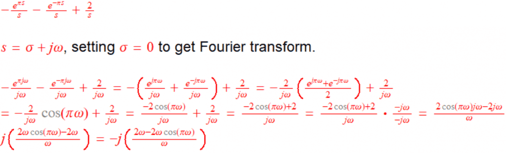

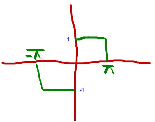

I was trying to find Fourier transform of two rectangular pulses as shown below. The inverted rectangular pulse has unit height, -1, and lasts from -π to 0. The other rectangular pulse has unit height, 1, and lasts from 0 to π.

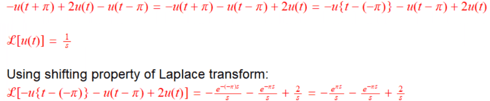

I was making use of Laplace transform and its time shifting property to work out the Fourier transform and would like to stick with this method.
Do you think my work is correct? Thank you.
Your final answer should be correct if you did the algebra correctly (which I think you did).
Here is why it worked. If you have some function ##f(t)## with Laplace transform ##F(s)## with some region of convergence, and Fourier transform ##\hat{F}(\omega)##, then ##\hat{F}(\omega) = F(j\omega)## only if the region of convergence for ##F(s)## includes ##\sigma = Real(s) = 0##. The region of convergence for your Laplace transform does include ##\sigma=0## so it satisfies that requirement.

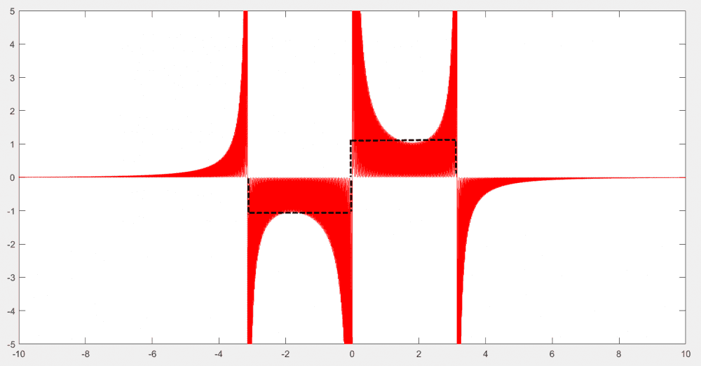

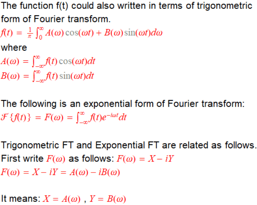

Anyway, I tried to verify it further using a Matlab code. I used trigonometric form of Fourier transform to plot the result. Please see the note below about the trigonometric form.
I set B(ω) = j{2ω-2ω*cos(πω)}/ω
The following is Matlab code I used. Please note that if you try to run the code, it would produce different warnings but it would work fine.

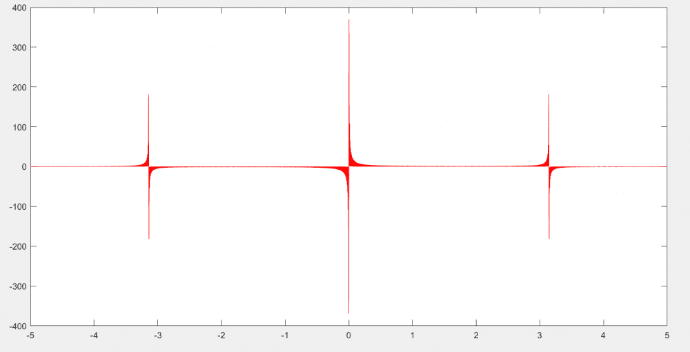

The plot below was produced using the code above. Note that black dashed lines were drawn by me for clarity. You can see my result is quite weird. I don't think there is a problem with my code but still I cannot figure the problem. In the code I have restricted the y-axis limits. The plot at the bottom, Plot #2, was produced without restricting y-axis.
Plot #1:
Plot #2:
I see an error in your algebra in the original post. I happens when you multiply the numerator and denominator both by ##-j \omega##. Also, if you have access to the symbolic toolbox you can use Matlab to do the analytical Fourier transform. The command is Fourier - on the command line type
>> help fourier
to see examples of how to use it. Likewise ifourier is the inverse Fourier transform. Also, the symbolic step function is called heaviside in Matlab.

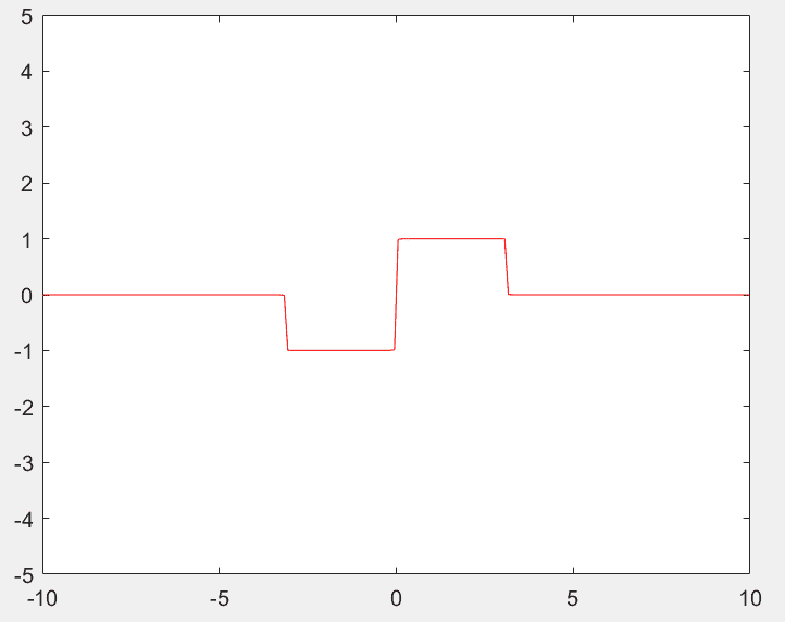

Thank you for pointing this out. I have fixed the error below.
It worked as well. The following plot was obtained after fixing the error in previous code.
