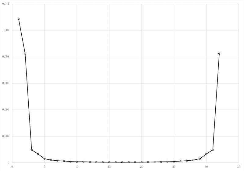

I take it that B_x and B_y are cartesian components, and you want the radial component in pane polar coordinates. So in less confusing notation what you are calculating is <br /> B_r(\theta) = B_y(\theta) \cos(\theta) - B_x(\theta)\sin(\theta). Now you have values of B_x and B_y at what I assume are 50 distinct points equally spaced around a circle at fixed distance from the source. This gives you B_x(\theta_k) and B_y(\theta_k) for \theta_k = 2\pi k/51, 0 \leq k \leq 50. It is then straightforward to calculate B_r(\theta_k) and obtain the (discrete) Fourier transform of these using the software of your choice.

My earlier post contained an error: \theta_k = 2\pi k/50 not 2\pi k/51 as stated.
What you are trying to find are the coefficients b_n in <br /> B_r(\theta) = \sum_{n=-24}^{25} b_ne^{in\theta}. These are determined by requiring that <br /> B_r\left(\frac{2\pi k}{50}\right) = \sum_{n=-24}^{25} b_n\exp\left(\frac{2\pi i nk}{50}\right) <br /> = \sum_{m=0}^{49} b_m\exp\left(\frac{2\pi i mk}{50}\right) for 0 \leq k \leq 49 and the second equality follows by setting m = n if n \geq 0 and m = 50+n otherwise, as \exp(2\pi i (50 + n)k/50) = \exp(2\pi i + 2\pi i nk/50) = \exp(2\pi i nk/50). This is the definition of a discrete Fourier transform.
You should not window the data, as you appear to have done: You expect B_r to be periodic with period 2\pi. From inspection, it looks like you will get the coefficients in the order <br /> n = 0, 1, \dots, 24, 25, -24, -23, \dots, -1.

Thank you for your answer, I really appreciate you give your best to help me - I'm just afraid this post confused me even more. I have this equation given as the one I need to Fourier tranform:
<br /> B_r(x) = B_y \cos(x) - B_x\sin(x) \hspace{4 em} (i)
Now what I did is make one row B_y and one row B_x which I can put in (i) to get a column B_r. For x I entered 2 \pi \cdot (\frac{1}{50}+a_{n-1}) with a being the distance covered with each measurement.
When I Fourier transformed these values it gave me this function:
I know that the 50 I entered above is arbitrarily, I just didnt know what to put as sample rate. I guess its far from what it should be as I expect the resulting graph to just have one peak and I also do not know how to use all the data I have as for what I did I can only use powers of two as amount of transformed values - so this graph just uses the 32 ones in the center (when I used 64 I added 14 zero values as I don't have enough data which seemed to mess up the transformation).
Now this is where I'm at. I don't feel like this is how to approach my problem but that's just what I got so far.
Now your advice is to use a different function for B_r. But I do not understand how your equation will get me to the data. I know that at least the first part should be okay if written as sine/cosine so I will end up having another column for B_r with 50 discrete values - is that right? Now those values are the ones I will have to Fourier transform. The excel add-in I use can only transform sets of 32 or 64 (and other powers of two respectivly) - is this some restriction that can be avoided? As far as I understood its not if I want to do a FFT? After I got those 50 values I just got their modulus (\IMBSA-function in Excel) and plotted the results (which you can see above). I feel like I am doing something conceptually wrong here but don't really understand what it is. You said I "windowed" my data - can you maybe tell me what that means (I'm no native speaker in english and have some problems when it comes to technical expressions)? I also feel like I should not get discrete values of B_r but instead a periodic function as you mentioned in the last paragraph. But what are the values to Fourier transform than?
I'm really sorry - I appear to be lacking some important prerequisite when it comes to this topic. Please excuse if I'm totally off in some of my assumptions I just really try to understand what I need to do but the major point appears to be missing.
Thank you in advance for your answers so far and - hopefully - for those yet to come!
