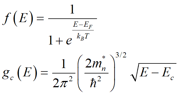

I just want to clear some confusion I am having with the Fermi-Dirac distribution & density of states (DOS) of a semiconductor, which are given by

For (1), it is straight forward: we just integrate the density of states function in the conduction band, gc(E) over the indicated range:

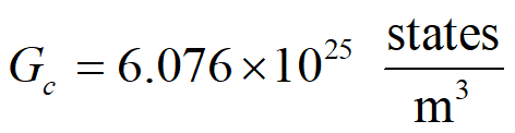

At room temperature and using an effective mass of silicon is, say, mn*=1.09m0. This yields
For (2), I know that the Fermi-Dirac distribution in this context represents the the probability of an electron occupying a state at energy E, which can also be interpreted as the ratio of filled state to total states at the energy. But I am really not sure what do here. Do I compute the difference of Fermi-Dirac distributions in that range, or do I integrate, or both are wrong?

Welcome to PF.
From part (1) you know the number of states (per m3) in the energy range ##E_c## to ##E_c + 2k_BT##. I think you can answer part (2) if you know how many electrons (per m3) have energies in this range.
Suppose you consider a small range of energies ##E## to ##E+dE##. Can you see how to get the number of electrons per m3 that have energies in this range? This will involve both ##g_c(E)## and ##f(E)##.
