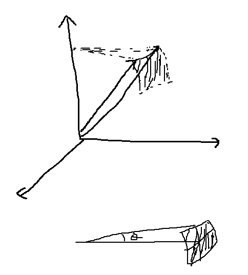

How do I find the fraction of particles getting through? I did this in the rest frame:
[tex]f = \frac{4\int_0^{\theta^*} \sin \theta d\theta \int_0^{\phi^*} d\phi}{4\pi} [/tex]
[tex]f = \frac{1}{\pi} \left(1 - cos \theta^*\right) \theta^*[/tex]

So I can do everything in the ion's rest frame? Then the fraction is simply ##f = \frac{4\int_0^{\theta^*} \sin \theta d\theta \int_0^{\phi^*} d\phi}{4\pi}##.
The ϕ integral is trivial, but the prefactor of 4 looks odd.

I used ##\int_{-\theta^*}^{\theta^*} = 2 \int_0^{\theta^*}##.
θ does not get negative at all, or I misunderstood your coordinate system.
(Even then, where does the other 2 come from?)
The cylindrical detector is on axis with the beam. ##\theta \simeq \frac{r}{D}##. So I think it should be ##\int_{-\phi^*}^{\phi^*} d\phi \int_0^{\theta^*} d\theta##
You need a really weird coordinate system to get negative θ. "The other side" should differ by pi in the angle ϕ, but not in θ.
Here's how I understand it: ##\theta## is the angle from the centre of the 'square' to the edge, so the area of the path is ##(r \sin \theta d\phi) \times (r d\theta)##. If I do ##\int_0^\theta d\theta \int_0^\phi d\phi##, it only covers 1/4 of the patch?
There is no square, the detector is a disk. With usual conventions for spherical coordinates, the angle goes from 0 to θmax or from -pi/2 to -pi/2+θmax, where the lower value is exactly in the center of the disk.
What do you mean with "area of the path"?

I meant the area of the shaded patch. My worry is that the angle ##\theta## is defined as the angle from the centre of the patch to the edge of the patch..and using limits (0,theta) and (0,phi) only covers 1/4 of the patch.
unscientific said:
My worry is that the angle θ\theta is defined as the angle from the centre of the patch to the edge of the patch.
That is the only reasonable definition.
It covers 1/2, and if you integrate phi from 0 to 2 pi you cover everything.

Surely the limits of ##\phi## can't be from to 2pi. Ok, so the limits for the fraction are: (-phi,phi) and (0,theta).
-pi to pi is possible as well, it depends on the choice of your coordinate system which you still did not reveal. The result of the integral has to be 2 pi, the definition of the angle is not so important.
I suppose that the origin is where the particles fly out, and the detector is situated ##200km## away.
Yes that is obvious, but how do you define the angles phi and theta?
Theta is the angle subtended from point of emission to edge of detector and phi is the same, but sideways.
That is a very unconventional and problematic coordinate system that leads to ugly integrals.
Spherical coordinates are so much easier.
Ok, how would the integrals with limits look like in the spherical coordinate system?
Theta is the angle to the central axis (polar angle), phi is the azimuthal angle. Phi runs from 0 to 2 pi, theta from 0 to the maximal theta.
