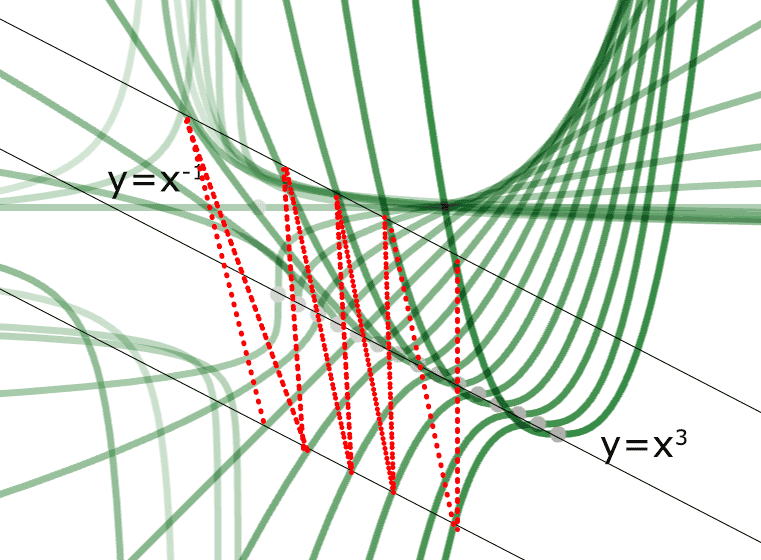

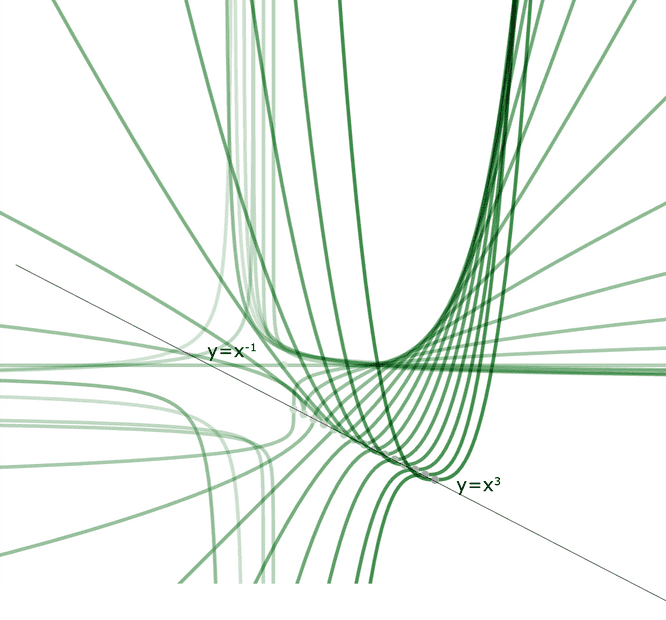

So I sketched this up using an online 2D plotter. (I manually overlaid each 2D graph in Photoshop, and gthen offset each layer by a few pixels, to make an ersatz 3D plot.)
This is the graph of y=x z, for the values of z=3.0 to -1.0 by increments of 0.2.
That "tail" in the lower left quadrant flips from negative to positive discontinuously every time I cross an even decimal such as n.8 or n.4:
What will happen if I take smaller increments of z, such as .1, or .01? Will the graph ever be continuous, or will it always have these discontinuities? How far down the decimal rabbit hole will the discontinuities go? Is there a fixed number, or does the number depend on the resolution?

I don't see why. It is a simple xyz Cartesian graph with the z-axis protruding from the page in increments of .2b (the grey line is the z-axis). The x and y axes have been removed for clarity because I'm only really interested in a qualitative view of the surface in this rough sketch.
There may be other preferred ways of visualizing the data but that doesn't make this visualization misleading. (Albeit the crudeness makes it hard-to-read.)

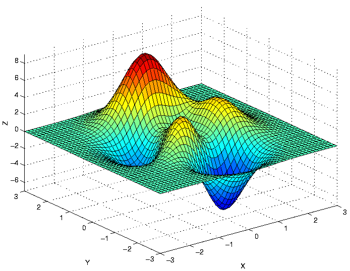

Here is a similar graph. It has different data and better visualization, but it is fundamentally the same thing:
The z axis is protruding from the page at an angle. If I look at your overlaid drawing, I can identify the curve for ##y=x^{2.8}## and a curve for ##y=x^{-1}##. But the origins for the two curves do not coincide.
Be that as it may, let me try to explain what I think you are seeing.
Consider ##y=x^{2.8}##. What does that mean? ##x^{2.8}## can be computed as ##x^2 \times x^{0.8}## We treat ##x^{0.8}## as ##x^{\frac{4}{5}}## That is the same thing as the fifth root of ##x^4##. Always positive.
This means that ##x^{2.8}## is always positive.
Now consider ##y=x^{2.6}##. In the same way, that is ##x^2 \times x^{0.6} = x^2 \times x^{\frac{3}{5}}## The latter term is the fifth root of ##x^3##. Not always positive.
The 0.4 power is the same as the ##\frac{2}{5}## power which yields the fifth root of ##x^2##. Always positive.
The 0.2 power is the same as the ##\frac{1}{5}## power which yields simply the fifth root of ##x##. Not always positive.
If you reduce the step size, you will not get continuity. Which is why we do not usually try to define exponentiation within the reals for negative values of the base and irrational values of the exponent.
