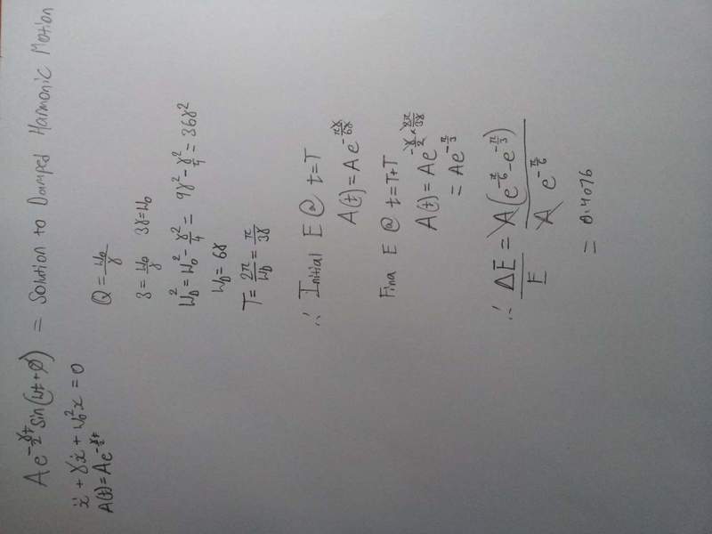

To everyone else : The problem is I have a question where the Q factor is 3 and I am asked to calculate the fractional energy loss per cycle.
I simply have no idea how to determine this...
Taking the standard form of the damped shm equation as [itex] \ddot{x} + 2\alpha \dot{x} + \omega_0^2 x = 0[/itex], then Q is defined as [itex]\frac{\omega_0}{2\alpha}[/itex].
So, knowing Q, you can express [itex] \alpha[/itex] in terms of [itex]\omega_0[/itex].
But you know that the solution of the damped shm equation is a sinusoid with an exponentially decaying amplitude, and you have equations for the amplitude, in terms of [itex] \alpha[/itex], and for the frequency of the sinusoid, in terms of [itex] \omega_0 [/itex] and [itex] \alpha[/itex]. From the second of these you can find the periodic time, T. Substitute this for t in the amplitude equation and the job is virtually done.
I think that, for Q = 3, the amplitude after a cycle is 0.35 of its original value. I would say, "Check your answer against mine", but I'm prone to slips.

My workings and answer are below. Could ou tell me if I've worked this out correctly ?
The structure of your solution is fine, but I've spotted one arithmetical mistake, and one place where you are making things more complicated than they need be...
First the arithmetic. The expression of [itex]\omega_D^2[/itex] in terms of [itex]\gamma[/itex] should read
[itex]\omega_D^2 = 9 \gamma^2 - \frac{\gamma^2 }{4} = \frac{35 \gamma^2 }{4}[/itex]
Now the simplification I recommend. Consider the fall in amplitude from t= 0 to t = T, rather than from t= T to t = 2T. [Incidentally, it's easier to think about what's going on if you use the cosine rather than the sine form of the solution. Then the displacement at t = 0 is simply the initial amplitude, A.]

After doing what you recommended I've found that ΔE/E = 0.65. Can you confirm to me whether that is correct ?
Thank you for all your help so far :)
This agrees with my answer given in post 6 !
Good luck with your studies. Physics is wonderful!
