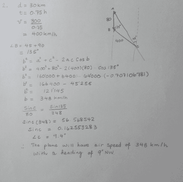

Hi, Could someone please have a look at my solution and let me know if I did it correctly.
Thank you!
1. Homework Statement
A pilot is flying from City A to City B which is 300 km [NW]. If the plane will encounter a constant wind of 80 km/h from the north and the schedule insists that he complete his trip in 0.75 h, what air speed and heading should the plane have?

You have a sign error. Unfortunately, you did not type in the solution, so I can not show, where the error is.
Likes aatari
aatari said:
Your diagram is wrong. You seem to have put label C where A should be and label A where B should be.
What direction does the resultant 400km/h need to be in?
Thank You!
