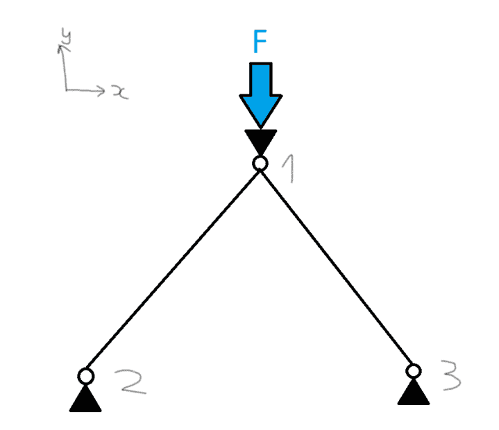

Hoping someone can chip in and help me understand a problem when it comes to two-force members.
I have a structure as shown below. Essentially its a single body attached at 3 points with pin joints. My question is, is it appropriate to treat each of the left and right side as individual members, making them single two-force members and therefore have a reaction force in x AND y, at both point 2 and 3. Or is the fact that it's a single rigid body mean it can't be a two force member and there will only be a y reaction force at 2 and 3.

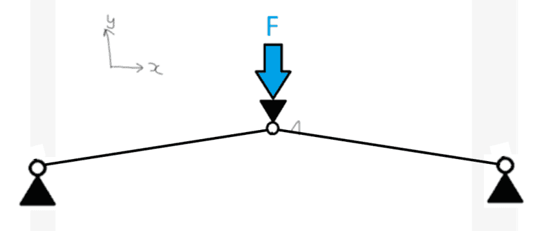

In the mean time: ask yourself if the members exercise a horizontal force on each other at point 1 ...
(do the experiment if in doubt !)
Well I don't get how this would be required to be a two-force member because we have 3 points that can counter any moments. So assuming point 1 is right in the middle between 2 and 3, there would only be a vertical (y) reaction at both points of 0.5F, no horizontal force?
I take it you did not perform the experiment ?
What about this not-so-subtle hint ? Still no horizontal forces at point 1 ?

I get what you're trying to show, and correct me if I'm wrong, is that you're implying that the steep angle means there is a horizontal force from both sides acting on 1. However, that only applies if I already assumed that there are axial forces only. My question is why? and how does this scenario differ from for example a bike shown from side view, with a cyclist sat right in the middle of the two wheels providing a vertical reaction force of 0.5*mg at each wheel, with no horizontal component.
I share your confusion because you have described a single rigid body, but your diagram represents an armature.
Each of those have different distribution of internal forces.
The main difference comes from the way in which points 2 and 3 stay put and keep the distance between them.
If the armature has a 2-3 rigid link, then links 1-2 and 1-3 can be each a two-force member and there will only be y-reaction forces at 2 and 3.
If that 2-3 rigid link does not exist, then supports 2 and 3 will need to have each x-reaction forces
that prevent the armature from spreading links 1-2 and 1-3 and from collapsing.
Normally, those x-reaction forces are possible due to friction or anchoring respect to a solid substrate such as ground.

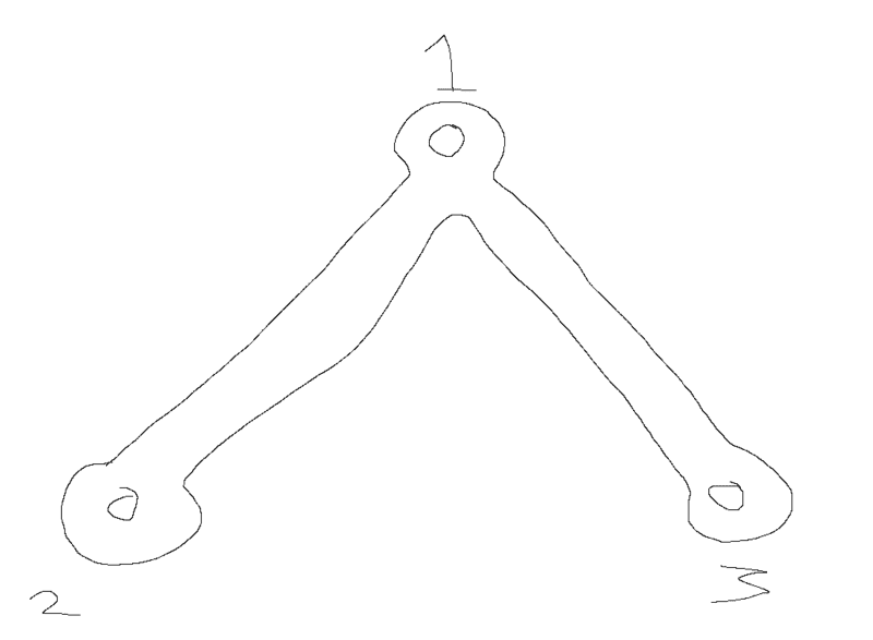

Maybe my initial post wasn't clear so I apologise. But what I was actually intended the links to be is a single body. Imagine a suspension control arm with 3 attachments (spherical bearings). So joint 1 has a solid connection that joins 1-2 and 1-3 together, it's all one rigid body, it's just the force is applied through a spherical bearing that would have a bolt going through it for example, hence the pin joint at 1. I think a typical truss example would have 1-2 and 1-3 be separate links, so with no joints at 2 and 3 any vertical load would split them. Wouldn't my case have internal bending preventing them from spreading and collapsing? Would this change the reaction forces?

Only if the body deforms. Which rigid bodies do not, by fiat. So the static rigid body is a just a triangle (or any shape with attachment at 1,2,3 and appropriate center of mass. I do not understand the elaborate nomenclature (two-force member????....reaction forces?...input-output forces? ) For me they are obfuscatory.

The bell crank is analogous to my FBD it seems.
So to clarify, for the second link you posted (movement 385), forces will only be reacted axially, as each link is a separate member?
Whereas the bell crank (movement 157), although has the same joints, can have reaction forces in any direction, dictated by applied load, this is because its one solid member and not two
Likes Lnewqban
Exactly.
For the second link I posted (movement 385), which is a mechanism, forces will be oriented axially, respect to each link.
Those links or members can only transfer traction or compression efforts; there is no moment to talk about.
Unlikely, the bell crank (movement 157), has one rigid joint, which loads the links with moment efforts, which value is always maximum around that pivot.
