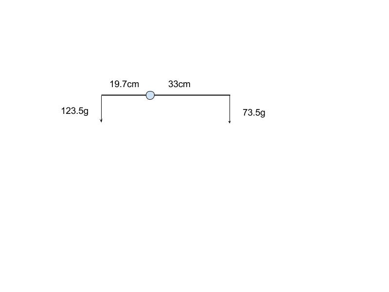

The idea was to achieve rotational equilibrium. Really I'm just not sure if I've included everything, or if I'm representing the experiment properly.
So that's a ruler balanced part-way along its length on a pivot point, and those are the moment arms and applied masses, right? And I'm guessing the masses were determined experimentally to balance the ruler on that pivot, right?
So to show the two torques acting on the ruler, you would draw the position vectors from the pivot point out to the two ends of the ruler, and show the forces at those two ends based on the mass values that were hung there. The vector torques will be based on those two quantities (position vector & force vector), and will have directions determined by the Right Hand Rule.
Can you take a cut at showing those vectors, and look up the Right Hand Rule to figure out how to get the vector torque? Also, it's best to draw a coordinate system to keep things straight. Center it on the pivot point for simplicity, and label x, y, and z unit vectors along those 3 axes...

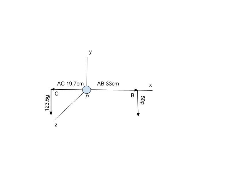

Ok I'm going to have to do some research. The right hand rule and position vectors is new for me. I'll post what I come up with later tonight.
That's what I got after doing a bit of research. Sorry the first one spazzed out.

So, what do you know about vectors and the vector cross product so far? Have you covered that in your classes yet?
If not, what tools have your instructors given you so far for calculating the vector torque's magnitude and direction from the magnitude and direction of the position vectors and the force vectors?
We haven't gone over cross products yet. We've done resolving force vectors with trig.
Resolving force vectors with trig is a step in the right direction.
In this problem, because the force vectors are perpendicular (90 degrees) to the position vectors, that simplifies things a bit.
But you still need to use the right hand rule to tell you what the sign of the vector cross product (direction) is.
Do you have access to a TA or office hours to ask how you are supposed to represent the vector torques in this lab? Or are you supposed to somehow figure that out without any classroom sessions about this? It seems strange that you are given this important calculation to learn with the lab, without any introduction to the vector cross product representation of the vector torque in your classroom or TA sessions...
I could provide you lots of links to illustrate how to do this (or you can find them with simple searches), but it sure seems like those topics should have been covered in the class as preparation for your lab experiment...

We haven't gone over cross products. But if it's pertinent I would like to learn more about it even if just for the sake of being prepared for future labs or higher level classes. I have class tomorrow night and I'll ask my professor about the right hand rule and cross products. Links would definitely be helpful. Thanks for all your help and patience tonight.

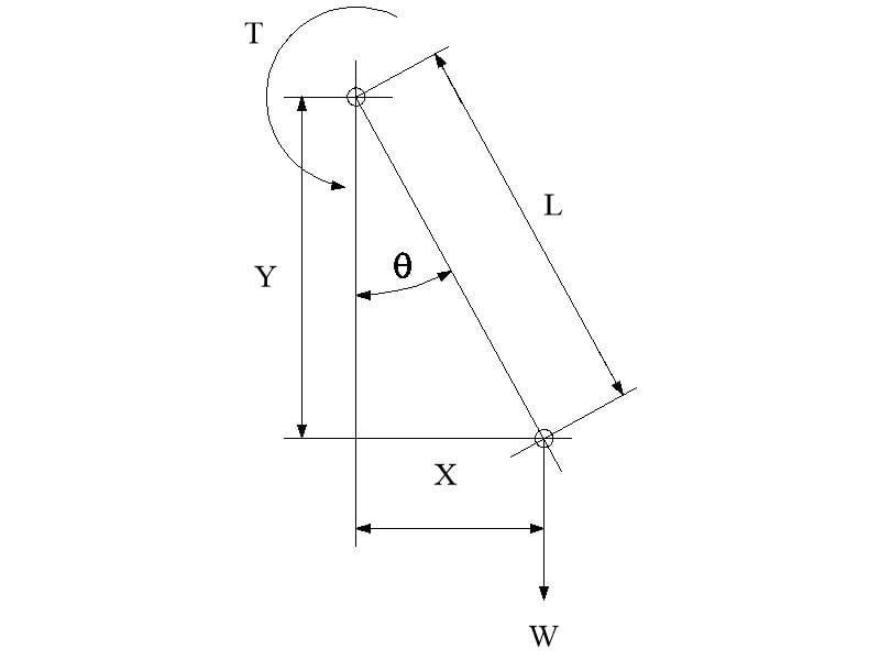

Would the more intuitive notation used in technical diagrams be ok for this problem ?
