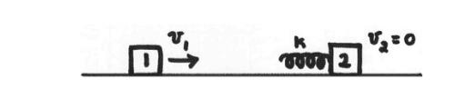

Suppose we are given the 2 following masses 1 and 2, where 1 initially moves at velocity ##v_\rm{1}## and 2 is stationary. Note, however, that 2 is not bolted down to any surface - it is free to move around after collision. What would the free-body force diagram of masses 1 and 2 be, after they collide?
This is what I think it will be - I just want to check because I'm not 100% sure.

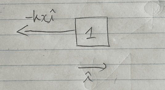

Suppose the spring is compressed by length ##x## from its relaxed position after collision. Then the force pushing block 1 to the left is the spring force of magnitude ##kx##:

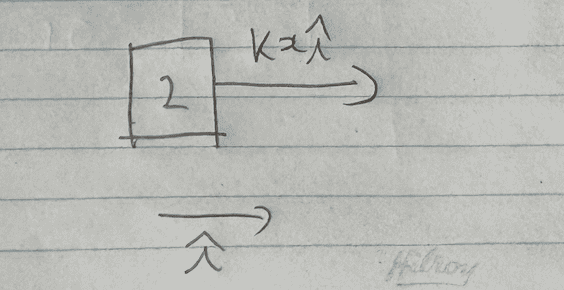

Similarly, from the perspective of block 2, the spring is compressed by by length ##x## too, so it will push block 2 to the right by a force of magnitude ##kx##:
The reason I'm not sure if this is correct is because block 2 is allowed to move around - is the only force that is pushing block 2 to the right the spring force, or are there more forces?
I'd appreciate any guidance to this problem.
Your diagrams are correct for the horizontal forces acting on the blocks. However, to make the diagrams complete, you should show all of the vertical forces also.
