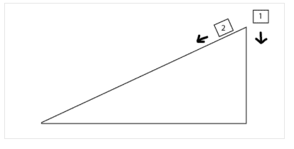

I think that would be true in the absence of friction.jaguar___ said:Homework Statement
which one would be faster when reached the ground?
conservation of energy
Pe=Ke
mgh=1/2mV^2
for 2-)m*g*cosa*(h/cosa)=1/2*m*V^2 -- V= sqrt(2*g*h)
for 1-) V=sqrt(2*g*h)
so V1=V2
You can say anything you want. Does it make sense in the context of the situation?jaguar___ said:can we say if the inclined plane is ice and also the weights are ice there wouldn't be friction? or so small that can be ignored?
