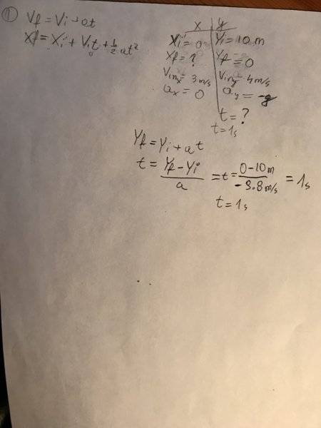

A 0.1 kg nut is thrown by a squirrel off of the top of a 10 m tall tree. It is thrown with an initial upward velocity of 4 m/s and an initial horizontal velocity of 3 m/s.
a) How long till it reaches the top of its arc?
b) From the top of its arc how long till it reaches the ground?
c) How far will it travel horizontally from the moment it is let go to when it reaches the ground? (Consider the combination of the time in both parts a and b.)
Vf=Vi + at
Xf= Xi + Vit +1/2at^2
am I applying information correctly?
to find time i should Yf= Yi+at ?
I am lost for a) I should use Vf= Vi + at
and for B) Yf= Yi + Viyt + 1/2at^2
Did you mean that? I assume Yi and Yf are heights.
If X means horizontal, what is a?
Yes.
You can, but define exactly what you mean by Yi, Vi and t here.
Yi is initial height
Yf is final height
a=0 right?
haruspex said:
You can, but define exactly what you mean by Yi and t here.
Yi - initial height and t is the time
Yf is final height
Then the equation is wrong. The right hand side, at, has dimension of velocity. Elsewhere you have correctly used Vf= Vi + at.
poh said:
a=0 right?
In that equation, yes.
I wrote "exactly". You are asked to consider the trajectory of the nut in two stages, from being thrown to reaching top of arc, then from top of arc to ground. Which point are you considering "initial" in this equation and to what interval does t refer?

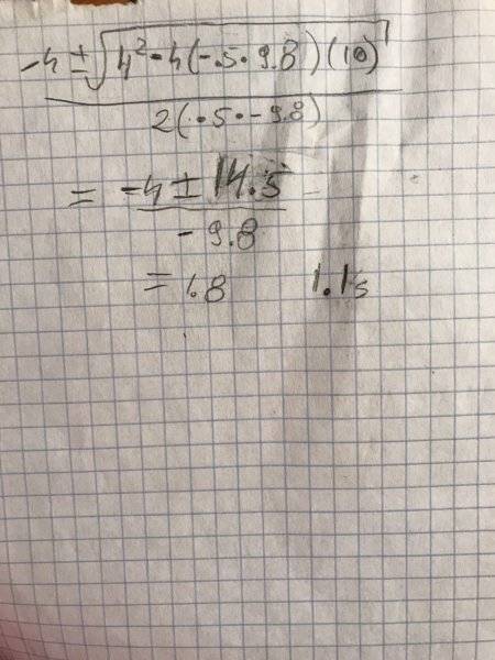

divede t by itself or I should use square roof to take out t^2 ?When I assume Viy = 0 then I got 1.4s
It is a quadratic equation. Use the formula.
i got 1.1s
poh said:
i got 1.1s
I get something different. Please post your working.

I did mistake in calculations.. my new calculations are 1.8 or 1.1
Again, be careful with signs.
You also need a bit more precision.
-1.1 and 1.9s
poh said:
-1.1 and 1.9s
Yes, that's better.
Clearly you want the pisitive answer, but the negative one also has a physical meaning. Can you see what it is?
Oh, and remember that what you have found is the time from being thrown up. Is that what you were asked for?
haruspex said:
Yes, that's better.
Negative means that's going down?
Sort of.
The equation you solved is valid forwards and backwards in time. If you imagine the nut being thrown from ground level 1.1s earlier, with just the right speed and angle, it would have passed the monkey at "time 0" and continued on exactly the same trajectory described by your equation.
And please note the edit to my preceding post.
