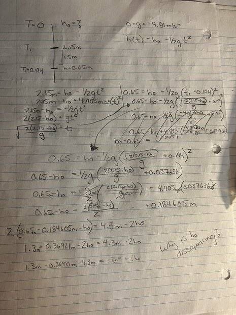

A tree has two devices attached to its trunk which are triggered when objects pass in front of them. The devices are vertically aligned and are placed 1.50 m apart, with the bottom one being 0.65 m above the ground. You climb the tree and decide to experiment to find out how high h0 above the ground you are. You release your wallet from your level so that it will pass in front of the motion detection devices. Once you've climbed down, you read that the lower device was triggered 0.194 s after the first one. Neglecting air friction and assuming that the wallet did not hit any branches on its way down, how high h0 had you climbed the tree?
h=1/2gt^2
I'm stuck on this problem, I've tried to follow techniques for similar questions, namely I seem to be struggling with these questions where I have to use an equation inside an equation. I've attached photos of my process so far, but obviously, I'm not getting the right answer because what I'm trying to solve for is being canceled out of the equation unless I messed up somewhere in rearranging the equations.
Help is much appreciated.
You know that the wallet takes 0.194 s to travel 1.50 m between sensors. You can write an equation relating the two quantities which will have one unknown. What quantity is that? How can it help you solve the problem if you know its numerical value?
is it the y=y0+vot-1/2gt^2 equation?
I'm confused because v0 would be zero since it was dropped, and I already know y values for this specific time, so everything in this equation is already known right?
I am talking about the transit time ##T = 0.194~##s required for the wallet to travel distance ##L=1.50~##m. What equation can you write that relates ##T## and ##L##?

Use the first one but adapt it to the motion between sensors.

If you know the time taken to traverse a known distance, that gives you a velocity. An average velocity.

OK, good. So we have an average velocity over some range.
Now we need to be more specific. It is an average over what time range? I am not fishing for a numeric answer. I am fishing for an answer more like "the time from when <some mumble> to the time when <some other mumble>".

Stop with the squared velocities already. You do not need them. This is way easier than that. You have answered correctly: The average velocity is from the time when it passed the first sensor to the time when it passed the second sensor.
Where do we stand now? We know an average velocity. It would be more helpful (and would pretty much immediately solve the problem) if we knew an instantaneous velocity at some event. So we need to work toward such an answer.
There are a couple of ways to proceed. I have one in mind.
We are under constant acceleration, yes?
We also know the acceleration rate, yes?
Next question:
Given constant acceleration, is the average velocity over a time interval equal to the instantaneous velocity at the midpoint of that time interval?

This is why it's important to know some mathematics. You have your basic equation:$$y = y_0 - \frac 1 2 gt^2$$And you have ##y## at two different times$$y_1 = y_0- \frac 1 2 gt_1^2$$$$y_2 = y_0 - \frac 1 2 gt_2^2$$Whenever you have two equations you can try adding or subtracting them. If we subtract the second equation from the first we get:$$y_1 - y_2 = y_0 - \frac 1 2g t_1^2 - y_0 + \frac 1 2 gt_2^2 = \frac 1 2 g(t_2^2 - t_1^2)$$Now, one thing you must know and never forget is that, for any numbers, we have$$a^2 - b^2 = (a-b)(a+b)$$That's one of the most useful things in all of mathematics. If we apply it here we get$$y_1 - y_2 = \frac 1 2 g(t_2 - t_1)(t_2 + t_1)$$Now, in this case, we know ##y_1 - y_2## and ##t_2 - t_1##, so we can calculate ##t_2 + t_1##. And, if we know ##t_2 - t_1## and ##t_2 + t_1##, then we can solve those simultaneous equations to calculate both ##t_1## and ##t_2##. Then we can get ##y_0## directly from either equation.
There may be quicker ways to get the answer, but that shows how basic mathematical technique can crack these problems. And why just plugging numbers into equations may not get you very far.
