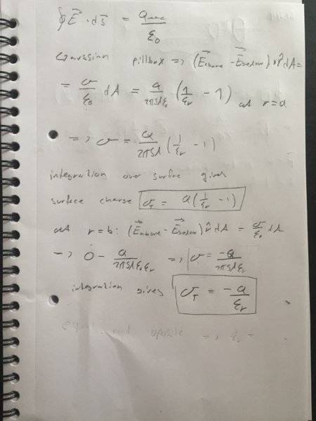

However, I did a new calculation, I did a little wrong above.
See picture.
So now I think I have the total surface charge for both the cylinders. However, there's still bound charge present. How do I differentiate bound and free charge, so I eventually can extract only the free surface charge from the total surface charge?

Your calculations are leaving off an important step or two in the solution. I recommend you use the equation ## \nabla \cdot D=\rho_{free} ## where ## D=\epsilon_o \epsilon_r E ##. You can do the calculation just using ## E ## and deriving everything else from ## -\nabla \cdot P=\rho_p ##, but it's easier to use ## D ##. ## \\ ## With this equation, Gauss' law reads ## \int D \cdot dA=Q_{free} ##. You seem to get the correct answer for ## \sigma_pa ##, but you aren't showing the steps to get there. ## \\ ## And yes, your equation ## E_{above}-E_{below}=\frac{\sigma_{pa}}{\epsilon_o} ## is correct. ## \\ ## And, yes, it is bound polarization charge, usually called just simply polarization charge. ## \\ ## Using the ## D ## form of Gauss' law with a pillbox around ## r=a ## gives: ## \\ ## ## \epsilon_o \epsilon_r E_{above}-\epsilon_o E_{below}=0 ##, so that ## E_{above}=\frac{E_{below}}{\epsilon_r} ##. ## \\ ## This gives ## E_{below}(\frac{1}{\epsilon_r}-1)=\frac{\sigma_{pa}}{\epsilon_o} ##. ## \\ ## ## E_{below} ## is readily found: (Edit) ## E_{below} 2 \pi \, a L=\frac{\rho \pi a^2 \, L }{\epsilon_o} ##. ## \\ ## Now we can simply solve for ## \sigma_{pa} ##. (I think you got that part correct). ## \\ ## Because this is polarization of the dielectric between ## r=a ## and ## r=b ##, ## \lambda_{pa} L=-\lambda_{pb} L ##. ## \\ ## (It can be shown that ## -\nabla \cdot P=\rho_p=0 ## inside the dielectric, so that the only polarization charge is surface polarization charges. The net polarization charge must be zero. Alternatively, ## \int D \cdot dA =Q_{free} ## so that ##\epsilon_o \epsilon_r E(r) 2 \pi r=\rho \, \pi a^2 ##. We can compute ## \nabla \cdot E(r)=\frac{\rho_{total}}{\epsilon_o}=0 ## in the dielectric, (google "divergence in cylindrical coordinates"), so that ## \rho_p =0 ## in the dielectric. ) ## \\ ## This is why you need the surface charge per unit length.## \\ ## Now ## \lambda_{pa}=\sigma_{pa} 2 \pi a ## and ## \lambda_{pb}=\sigma_{pb} 2 \pi b ##. You need these last two relations to solve for ## \sigma_{pb} ## from ## \sigma_{pa} ##.
