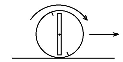

It might help to consider the system shown below where the water is replaced by a rod.
This shows a hollow ball rolling without slipping. Inside the ball is a vertical rod that is free to rotate about its center. The rod is initially not rotating (it is just translating to the right with the ball). When the two little pegs simultaneously strike the ends of the rod, the rod sticks to the pegs so that the rod ends up rotating along with the ball.

Try to find a specific point in space about which the angular momentum of the system will be conserved. A free body diagram showing all external forces acting on the ball-water system will be very helpful.

Well, I think it would be best to pick a fixed point in an inertial reference frame. The point of contact of the ball with the ground is moving relative to the ground (it's always vertically under the center of the ball), and this point might change its speed relative to the ground while the water freezes.

Hi, rude man. Are you assuming that the water is initially not rotating with the ball but the ice does rotate? If so, then I think KE will change if we assume the ball always rolls without slipping on the ground.

I agree. It might seem strange that the KE changes, but it must.

Yes. It's not too hard to work it out explicitly. The behaviors of the angular velocity and the total angular momentum about the center of the sphere are also interesting.

There is a difference between taking a fixed point, which happens to be the point of contact at some instant, as the reference, and taking a reference that moves with the current point of contact. The second is not an inertial frame, and will not give the right answer.

For angular momentum of a system to be conserved about an axis, you must choose the axis so that the external forces have no net torque about it. What external forces are there? What choice of axis does that lead to?

Right. So what axis can you pick so that friction exerts no torque?

One which passes through both CM and point of contact. ..
Why through CM? What force has a torque about that?

No force would produce torque about that. I think any axis passing through the point of contact should work fine.
Yes, but it does not even need to pass through the point of contact. You just need that at no time does friction torque have a torque about it.
Also, to be useful, the rotating ball does need to have angular momentum about it.

There are two ways to solve this problem.
1. Let the frictional force be F, write one equation for linear momentum and one for angular momentum about the centre of the ball.
2. Choose the axis for angular momentum such that friction has no torque about it. Angular momentum about that axis is conserved, so you only need one equation. You do not to consider linear momentum.
