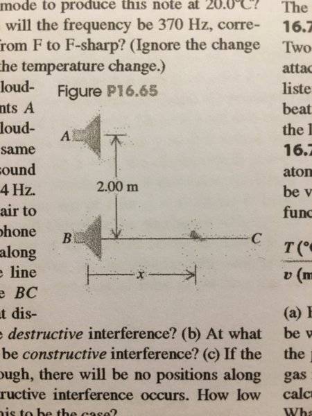

Two speakers A and B, 2.00 m apart, produce a sine wave at the same frequency and phase. A microphone is placed on the line BC perpendicular to AB, at a distance x from B. The speed of sound is v=344 m/s.
For a frequency ƒ low enough, there will be no destructive interference along the line BC. Find this frequency.

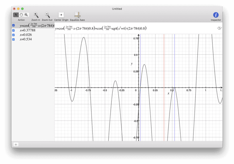

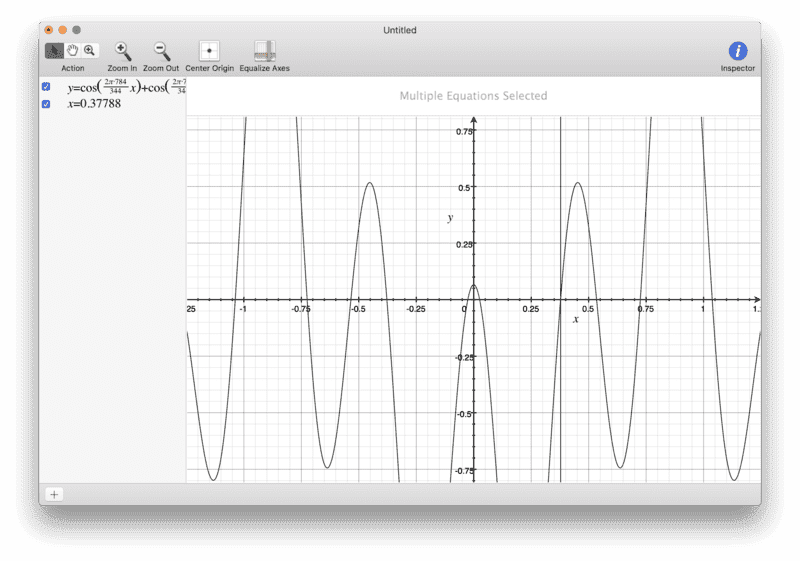

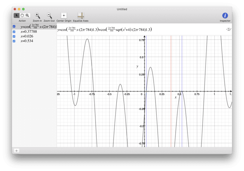

as for ##y_A=-y_B## at time ##t=0##:
##y_A+y_B=0\\
A\cos(\frac{784*2\pi}{344}x(-5))+A\cos(\frac{784*2\pi}{344}\sqrt{x(-5)^2+4})=0\\
\cos(\frac{70065\pi}{40678})+\cos(\frac{377393\pi}{40678})=0\\
0.64329-0.64329=0\\
0=0##

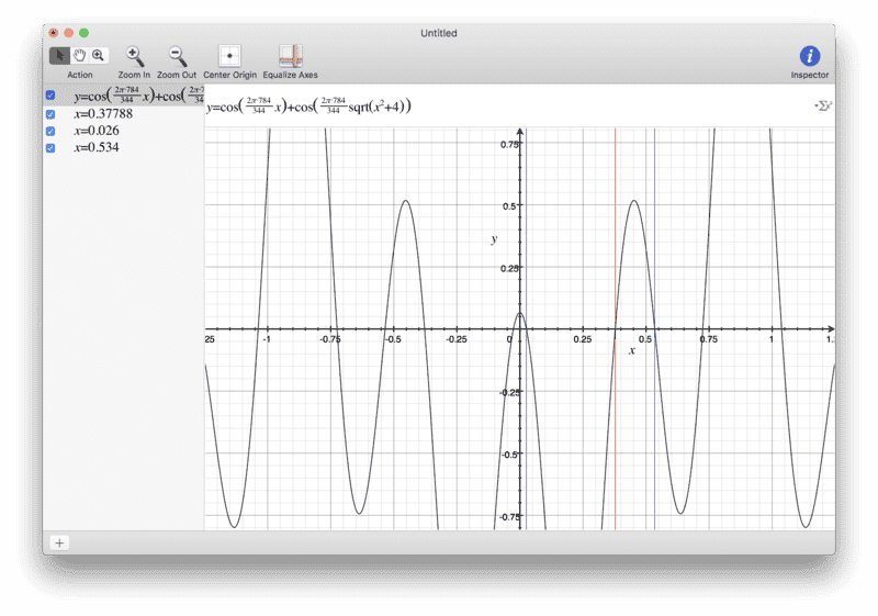

Graph of ##y_A+y_B## showing that 0.37788 is indeed a root:
Here's a comparison of the roots for ##y(x)=y_A+y_B, f=784\text{ Hz}##, assuming an arbitrary amplitude of 1 for both waves, found at different values of ##t##.
The given set of roots include ##x(4)=0.026## and ##x(5)=0.534## (blue); the root in question is ##x(-5)=0.37788## (red).
at ##t=0##:
at ##t=0.8##:
at ##t=1.3##:
which shows ##x=0.37788## to be a root only when ##t=0##, while the given answers hold true for all ##t##.
