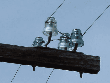

Ahh how far we've come... in mid 1960's i worked on Lenkurt telephone carrier systems for the railroad. They had their own telephone system on the poles that run alongside their tracks.
We thought 20 khz carrier with five voice signals was high tech. We had to "transpose" the wires at every pole to make them a 'twisted pair' that'd carry such a remarkably high frequency across Kansas and Missouri...
So i think the remark about "historical" is your answer.
Here's a transposition at a pole - the wires criss-cross, swapping places.
Makes them effectively a twisted pair. Higher the carrier frequency the more twists per mile.

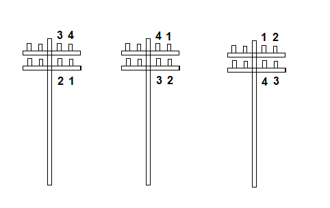

Them were the days :wink:. I was doing that as well for telecom in New Zealand during the late '70 and through the '80's
Even for just standard voice open wire lines we still transposed wires but the twist was done "in-span" rather than at the pole, unless a single pair circuit
numbers equal wire position on pole. this was mainly to stop pickup of electrical interference from external sources
EDIT ... I should have drawn successive poles in the other order. in the order seen they are from right to left :rolleyes:
