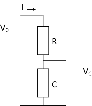

So am trying to find the Frequency response of a RC LPF between frequencies 100Hz-100kHz ,but i don't know what formula to use .

Trying to find the frequency response of this circuit
Write the KCL equation for the voltage ##V_o(t)## in terms of ##V_i(t)## and R and C. Do you know the differential equation relating current and voltage for a capacitor?

Sometimes it's hard answering these questions because I have no idea at what level an answer is expected. Essentially the question relates to plotting the magnitude of the transfer function for a simple passive low pass filter. Typically this is done on a logarithmic scale but that wasn't specified. Also it is common to actually plot angular frequency w = 2*pi*f rather than f alone as the independent variable. The transfer function itself is a complex number with both magnitude and phase. In this case it is 1/(1 + 2*pi*f*R*C*j) (as I think you suggested) where j = (-1)^1/2. The magnitude of this transfer function is thus H =1/sqrt(1 + (2*pi*f*R*C)^2). If you like you can can make a simple linear plot of this of magnitude vs f or a typical bode plot of 20*log10(H) vs log10(w).

I would do as berkeman said and use KCL. What's the show stopper for you? I'll help you setup the problem and show you an example. To do the plot you'll want to learn about Bode plots.

Seriously no need to invoke KCL. This is a simple voltage division problem. I'm sure that you know that if you have a voltage source in series with 2 resistors R and R2 that the voltage drop across R2 (your output voltage) is simply
Vin*R2/(R + R2)
In this case "R2" is the complex impedance of the capacitor namely 1/(j*2*pi*f*C). As you know you can use simple DC techniques to solve steady state sinusoidal problems merely by using complex impedances. Multiplying this out and dividing by Vin on both sides will give you the transfer function representing the ratio of Vout to Vin. Since you are plotting a thousand fold range in frequencies it would be wise to use a log scale. I suspect that you know all of this as you posted a correct version of the transfer function initially absent the factor "j" in the denominator and the disambiguating parenthesis which I assume was simply a typo.
