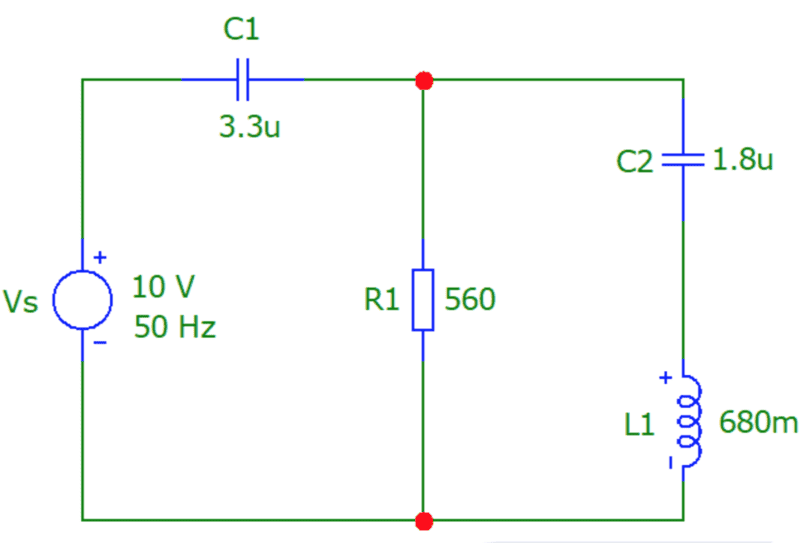

from the circuit plot the frequency response
fr Formula
use a frequency range from 10 Hz to 10 kHz and show that the circuit operates as a high-pass filter with a ‘knee’ point at 1 kHz
I have to be honest i an not 100% on what the question is asking me,
should i be working out Frequency resonance first using all the information provided, then i need to input this into a graph ?
Since the excitation frequency is fixed, you can write the phasor equation for the transfer function and use that to show that the transfer function is HPF. You can also use that to calculate the "knee" breakpoint frequency; I don't think you need to plot anything unless you want to.
Although depending on where the output is defined on this circuit, it is a more complicated transfer function than just a simple HPF, IMO. Maybe it would be useful to plot the frequency response with some free SPICE program like LTSPICE to help you visualize the transfer function.
Neither am I.
What frequency response? What are the inputs and outputs?
It's hard to help people that don't give you any information to work with about their confusion. Can you show us an attempted solution? Or ask a more specific question? I don't know what you know and what you don't.
"Plot the frequency response" - as exact as possible or as a classical Bode-plot which uses asymptotic lines only?
In the first case, you need the complete transfer function H(s) - while in the 2nd case, you can use some rough considerations for finding the corresponding slopes and the breakpoints (poles and zeroes).
In any case, the transfer function can be found relatively easily. In principle, it is nothing else than a complex voltage divider where the "load impedance) is R1||(Z_C2 + Z_L1)

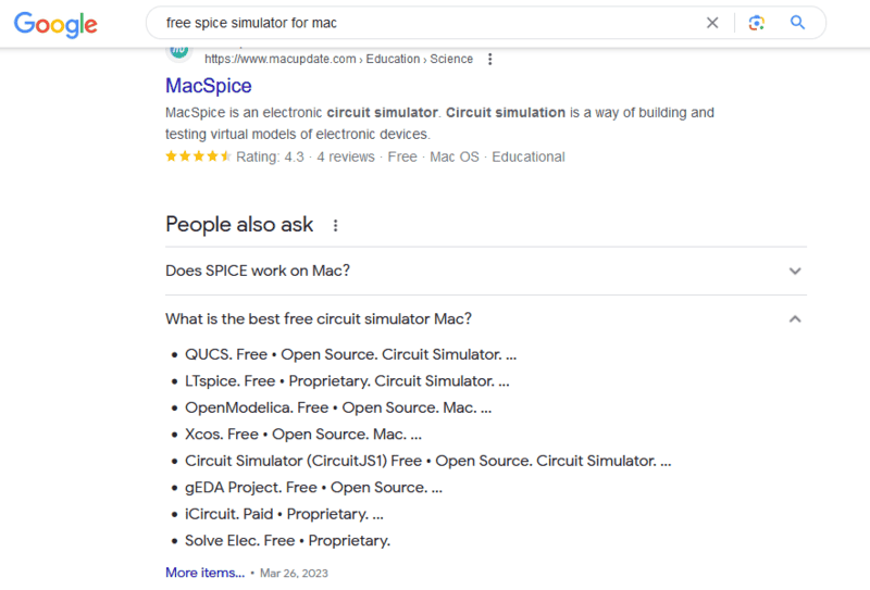

i would like to have a go at using the simulator but the links i have been sent are all for Pc and im a mac
Maybe try a Google search like the one below:
Likes Lord Jestocost
LTSpice. It must work on a Mac, since everyone uses it.

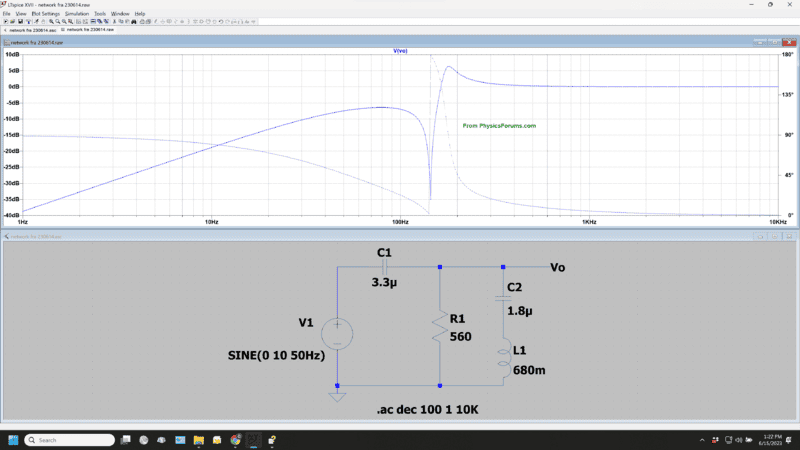

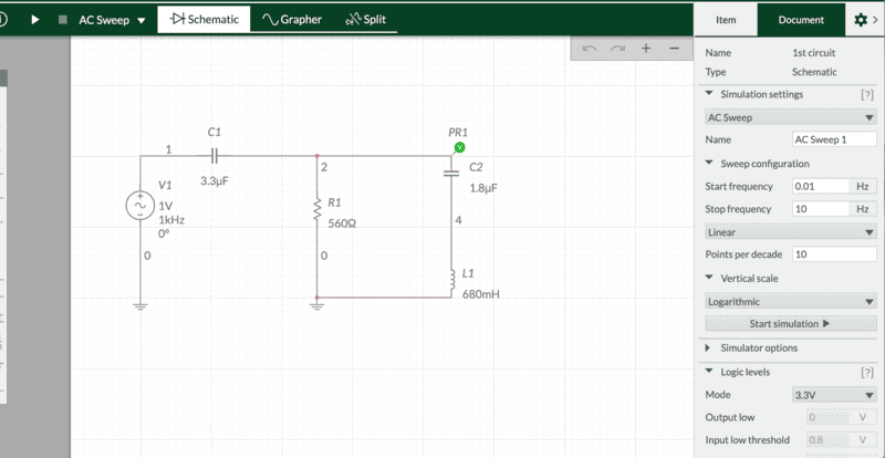

ok so i found this one, not sure i have done it correctly, looks like a high pass filter to me in the simulation

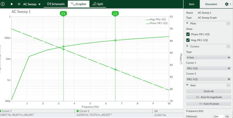

In post #1 you said you are supposed to "use a frequency range from 10 Hz to 10 kHz".
You have shown a sweep from 0 Hz to 10 Hz. Redo the sweep for the required range and what do you get?
It would be good to make the horizontal axis logarithmic.

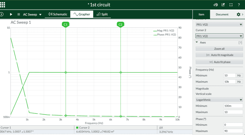

ok here is what i looks like now
You really need to make the frequency axis logarithmic. Also, you don't have enough resolution on the frequency axis. What is the step size during the frequency sweep?

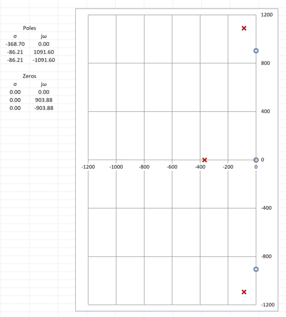

You correctly show conjugate poles at a little over 1000 radians, but the problem asks the TS to show that there is a "knee" at 1000 Hz, which would not be produced by a pole at 1091.6 radians. I wonder if the problem poser meant to say radians rather than Hz?

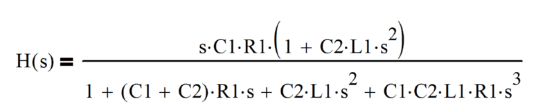

You actually can do a pretty good approximate factorization of that cubic, for the values given, which yields this.

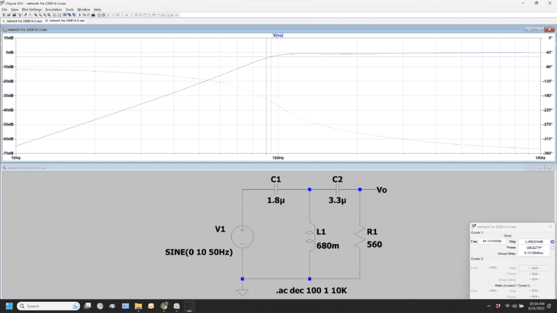

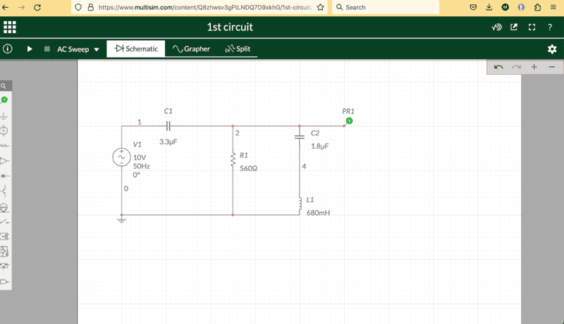

i was away for a few days, sorry, so i need to move the response ?
does this look more like it ? problem is i need to show freq range between 10hz and 10khz
Its probably a setting i need to chance, but i have not used this program before

When I click on the first screenshot, it shows a plot from 10Hz to 10 kHz, so you're ok. Your problem says that you are supposed to show that there is a "knee" around 1 kHz, but your plot doesn't show that. You should ask your instructor if you have been given the correct circuit.

If you gave me a box with those parts in it and asked for a HPF. I would build the circuit below. You just aren't going to get a 1KHz knee with those component values, they are too big. The closest you'll get is to cheat and put the two caps in series to make a 1uF equivalent which will give a quadratic pole at 179 Hz, which is about 1K rad/sec. Or you can leave the inductor out and get single pole at 244 Hz.

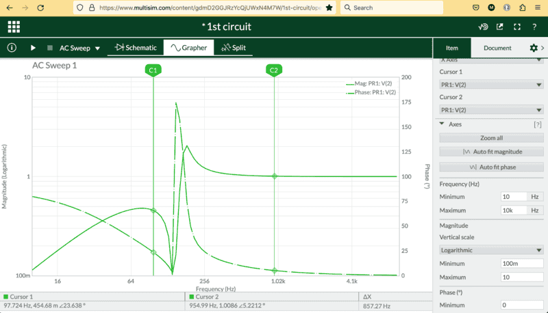

I appear to be on the same course as the OP, and I have tried multicap and multisim and both gave me the same answer which neither have a "Knee" point at at 1kHz. Interestingly, the course work does little to prepare you for this question, as its the final question in the assessment paper, and the final section of the course work is related to transformers and not RLC circuits.
