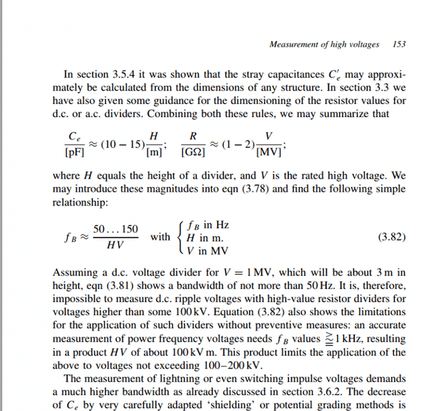

I've never done one either. Google suggests this book covers high voltage dividers including the effects of stray capacitance on resistive dividers.
High-Voltage Test and Measuring Techniques By Wolfgang Hauschild, Eberhard Lemke

See if you can find a copy of this book, "High Voltage Engineering Fundamentals" E. Kuffel, W.S. Zaengl.
Ch 3.3 is HV measurement with voltage dividers
