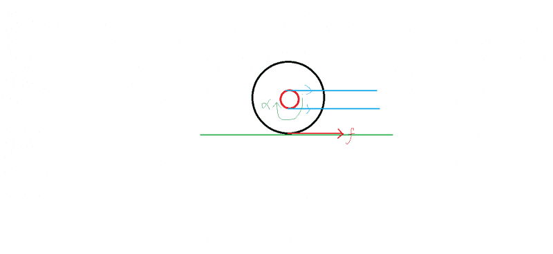

I was wondering, why friction acts in the tangential direction only when the car is accelerating? I mean, even if it moves in a circle with constant speed then it's tangential motion should be opposed.
I thought about that and I came up with this :rolleyes: --
If we assume assume that car's wheel rolls on the road then if it moving with constant speed then no external force should act in tangential direction. As the wheel is rolling so static friction should act in tangential direction but as no other force is acting on it so frictional force would be zero (as it is a static friction so it can be zero). But in radial direction ##mv^{2}/r## is acting so ##f_{s}=mv^{2}/r## (assuming that, the car does not slips). What do think BvU, is my explanation correct?:wideeyed:
When the spinning wheel is kept on the ground then friction acts to oppose the spin. Suppose if a wheels roll on a rough surface (also assume a external force is applied at the center) then friction (f s f_{s} ) acts on opposite direction to F F to satisfy the condition a=Rα a=R \alpha . But then it acts in backward direction.:olduhh:
This is not what was described in the problem statement ! Where, tell me, does this mysterious red F come from ? Is there a horse pulling the car or something ? In that case yes, the friction to make the wheel rotate is pointing backwards.

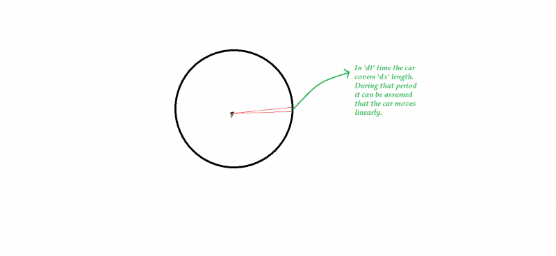

I was wondering, why friction acts in the tangential direction only when the car is accelerating? I mean, even if it moves in a circle with constant speed then it's tangential motion should be opposed. -- hard to comment; I don't follow what you mean with "it moves in a circle with constant speed then it's tangential motion should be opposed"
-- actually, you need to compensate for wind resistance by pushing the road backwards: sum of external forces is zero
As the wheel is rolling so static friction should act in tangential direction but as no other force is acting on it so frictional force would be zero (as it is a static friction so it can be zero). -- where the wheel touches the road, the rubber is moving straight down, then up again. Hence the desire for hard tyres and a hard road surface: that minimizes nuisance resistance. So that kind of resistance isn't all that big.
But in radial direction mv 2 /r mv^{2}/r is acting so f s =mv 2 /r f_{s}=mv^{2}/r (assuming that, the car does not slips). -- you make it seem as if that's two things, when it is only one: FS. (But I may be wrong).
What do think BvU, is my explanation correct?:wideeyed: -- try to split the problem a bit: some things are more easily considered when thinking about linear motion.

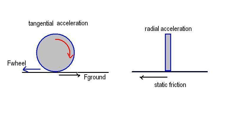

Friction is a force, it has both tangential and radial component. Even the mechanism as it acts can be different. See the pattern on a tyre.

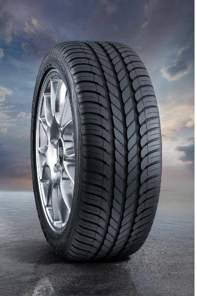

The ribs near the rim are a bit like those of a cogwheel. When the tyre accelerates, they push the ground horizontally, and it pushes back providing the accelerating force to the car.
In a curve, the tyre must not slide radially outward, perpendicular to its direction of travel. The static friction acting perpendicularly to the rim prevents that sliding.
Fwheel is the force, the spinning wheel pushes the ground, and Fgound is the force, the ground pushes the car forward.
The friction is static in both cases, it prevents the surfaces in contact from sliding. But the wheel is active in the first case, it exerts force on the ground which pushes back. In the second case, friction opposes centrifugal force (or supplies the centripetal force needed to turning round).
View attachment 81342The friction is static in both cases, it prevents the surfaces in contact from sliding. But the wheel is active in the first case, it exerts force on the ground which pushes back. In the second case, friction opposes centrifugal force (or supplies the centripetal force needed to turning round).

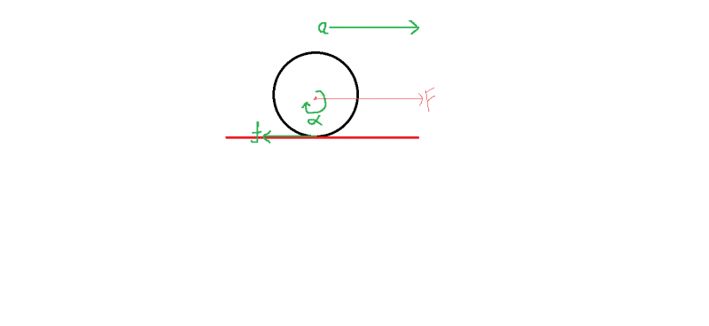

Friction (tangential component) acting on the wheels accelerate (supports the motion) the wheels in tangential direction. But in the you diagram(1) it acts in opposite direction of the motion of the wheel.:olduhh:
The force acting at the gear provides angular acceleration to the wheels.right? So the base of the wheels tends to slip in backward direction. So friction acts in forward direction. right?
As the force acting at the gear are internal force so they can not contribute to the CoM of the vehicle. So. friction acting the rear wheels are responsible for the motion of the vehicle. However the front wheel is not directly connected to the engine so friction acting on that is responsible for providing the the angular acceleration to the wheels so it should act in backward direction (opposite to the motion of the CoM of the vehicle). So net force which is responsible for the motion for the acceleration of the CoM of the vehicle is ##f_{rear wheels}-f_{front wheels}##. Am I right?

I meant Fground the force the ground acts on the wheel and it is forward. Fwheel is the force, the spinning wheel pushes the ground backward.
You are completely right.
The engine rotates the gear with increasing angular speed and that causes angular acceleration of the connected wheels. The wheels push the ground backwards, the ground pushes the whole car forward, together with the front wheels. If they were not able to rotate, the contact surface of those wheels would move forward. So the friction acts backward there, accelerating their rotation.
