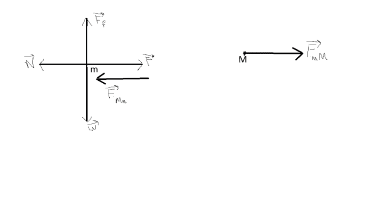

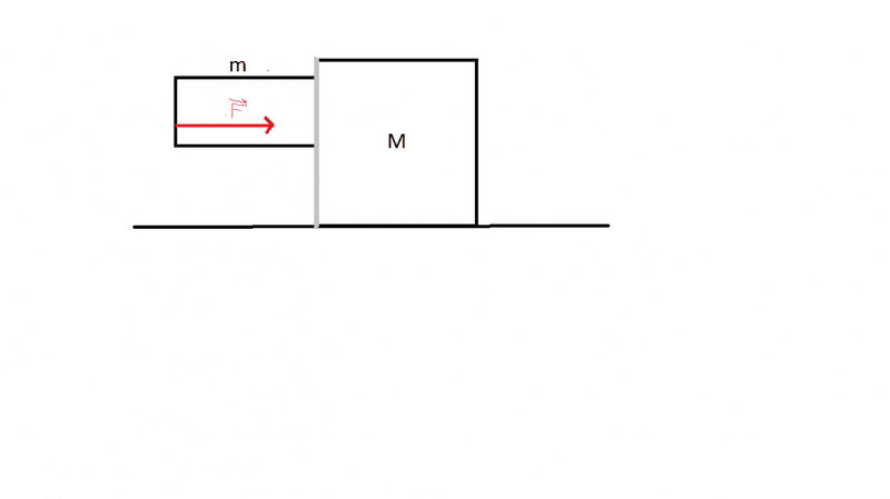

The two blocks ##(m=16 kg)## and ##(M=88 kg )## , are not attached to each other.The coefficient of static friction between the blocks is ##μ=0.33##, but the surface beneath the larger block is frictionless.What is the minimum magnitude of the horizontal force ##\vec F## required to keep the smaller block from slipping down the larger block ?
##\vec {F_t}=m\vec a##
##F_f=μN##
I made a free body diagram for m and M.Picture in attached files.
So I cannot find ##F_{mM}## or ##F_{Mm}## And ıf this was true M should move right but we don't know acceleration of ##M##. Is there some other force that I don't know ?
Thanks

1) If you apply a horizontal force to ##m##, what will happen to the system?
2) What would happen if the larger block were fixed to the ground? Could you calculate the required horizontal force on ##m## in this case?
What information do you know when the small block is right at the point of slipping - but does not slip downward?
1)I guess system will move ?
2)Required horizontal force for what ? I didnt understand ohh If u mean what I mean then ##F=\frac {mg} {μ}##
Can you put those two things together?
Hint: in the case where ##M## moves why is most of the applied force transmitted though ##m## to ##M##?

I would attack this problem in this order:
(1) What friction force is required between the blocks?
(2) What normal force (between the blocks) is thus needed?
(3) What acceleration is thus produced?
And so on.
(1)##F=μN##
(2)well I guess ##ma=F-N-F_{Mm}## from there ##N## equals to zero I guess but its wrong so ##a##should be zero I guess ??
or ##N=F-F_{Mm}## but this means there's no acceleration.
(3)##F=(M+m)a##
Arman777 said:
(1)##F=μN##
What must the friction force equal so that the block does not slip down?
weight which is ##mg##
Right. Now answer my question #2.

Do a force analysis of the big mass M.
##F_{mM}=Ma##
Arman777 said:
##F_{mM}=Ma##
What does ##F_{mM}## equal? (Consider your answers to questions #1 and #2.)
Theres no connection just there's ##F_{mM}## in N
as I said If ##N=F-ma-Ma## we get zero If I can write N I ll sove the queston.Just Idk why I can't write it.I am so annoying I know.

This is OK, but unhelpful. Instead, apply Newton's 2nd law to M instead of m.
I ll ask my prof next semester...Thanks
Don't give up. You are very close to the solution!
You applied Newton's 2nd law to mass m. OK. Now apply it to mass M. (And make use of the value you already found for N.)
  • #32
Is ##N= F_{mM}## ??
  • #33
Arman777 said:
Is ##N= F_{mM}## ??
Of course! (And you found N already.)
  • #34
Finally
  • #35
Ok I solved.Thx
