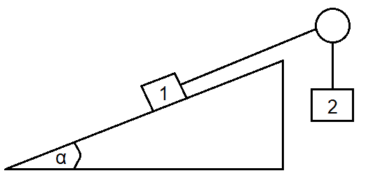

There is a mass m1 on an incline (angle α), connected to a pulley with a string, and on the other side of the pulley, after another string, there is a mass m2. See picture if it's unclear, I'm not sure how to express the problem.
Anyway the plane has a friction coefficient μ.
Need to find the Tension T of the string and the acceleration a of the system. Pretty sure I know how to solve the general problem, but I have an issue with the Friction Force.
F = m*a
Friction = μ * Normal force
As I said, my main problem is with the Friction Force. In particular, I don't know whether I should calculate the Normal force as the first or the second option:
1. Normal Force = Weight Force 1 * cos (α)
2. Normal Force = Weight Force 1 * cos (α) + Weight Force 2
In other words, I don't know if I should include the Weight Force 2. My first thought was to include only the first object, since it's the only one directly in contact with the plane, but since the second mass is also indirectly connected with the plane through the strings and the first object, I wonder if it should be included too.
Once that's found, the problem should be solved with F = m*a. So I would do:
(assume motion down the plane)
+Weight Force 1_x - Friction - Weight Force 2 = (m1+m2) * a
(Weight Force 1_x = m1 * g * sin (α))
That gives a.
Then, focusing on the second body:
+Tension - Weight Force 2 = m2*a
That gives T.

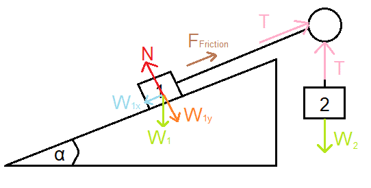

Merlin3189 said:
You need to look at the forces acting on M1 in order to find the normal force between it and the plane. A diagram showing these forces would help.
So I look at the forces acting "directly" on M1. In this case, they would be:
- T (tension)
- W1x and W1y maybe? Not sure if they count, since they have an effect on M1 (so they "act on M1" I presume), but they also "derive" from M1 in the first place...
- N (Normal Force) since it's the plane's reaction on M1
- FFric maybe?
Merlin3189 said:
As Doc says, there is a force on M1 that would not be there if M2 were not there. So you should show this on your diagram. You do not yet know the magnitude of this force: it would be a mistake to assume that this force is equal to the weight of M2. But that is not a problem - if you look at the diagram of forces, you can see why.
If you meant Tension T, yes, it's not equal to W2. As I said earlier, I would calculate it by putting together (in a system) the forces acting on each body. In an extended version, this is what I would do:
M1
Y axis has no motion since N + W1y = 0
X axis has (assuming motion down the plane and to the left): +W1x - FFric - T = m1*a
M2
X axis has no motion
Y axis has (assuming motion upwards): +T - W2 = m2*a
Put these together and you get a and then T.

Alex126 said:
- T (tension)
- FFric maybe?
All of these are forces acting on M1 so they all count and should appear on a free body diagram of M1. (Why in the world would you doubt that the weight of M1 -- which is the gravitational force of the Earth pulling down on M1 -- would count? Without gravity exerting forces on the masses, nothing much would happen here.)
Likes Alex126
Great. Just what I'd hoped for.
My only caveat is the direction of friction. The μN calculation tells you only the magnitude of friction. You could determine whether it is up or down the plane by comparing W1x and W2, to decide which way it slides. Here you can't decide, because you don't know W1 or W2. So you will calculate the magnitude of a, but not which way it is. For the magnitude it will not matter, because
|(W2-W1x)| - |F| = (M1 + M2) |a| whichever way you guess.
Likes Alex126
