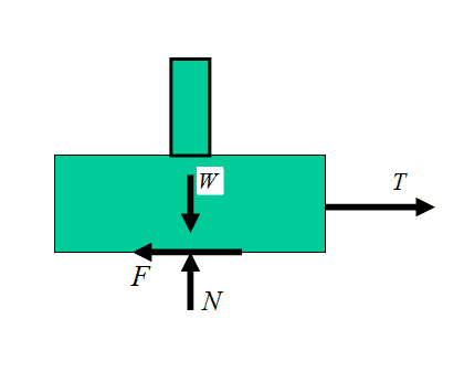

This is the free body diagram I had in mind.
W is the weight of the block and weights. N is the upward normal force exerted by the table on the bottom of the block. T is the tension in the wire applied by the spring scale. F is the friction force. This figure applies to all the cases, both static and kinetic, that you have been looking at. Since the block and weights are not accelerating in all cases, the force balances on the block (and attached weights) are:
$$T=F\tag{horizontal}$$
$$N=W\tag{vertical}$$
So the spring is always measuring the friction force in all cases.
Does this make any sense. Questions so far? (To be continued)
