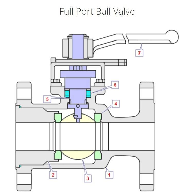

If you want a valve that is lossless when fully open, look at a full port ball valve:
The globe valve in the OP converts fluid kinetic energy into turbulence, then into heat. The energy is not destroyed, but is converted to heat.

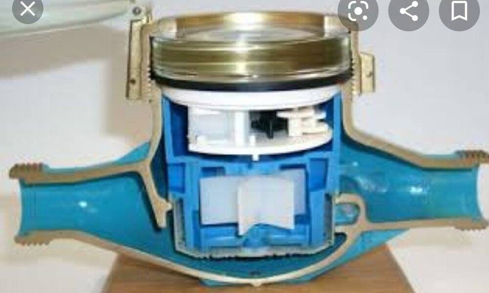

How about a water meter? If my input water pressure is 18psi.. how much is the output psi? Where is the energy loss?
Did you google "water meter pressure drop" before posting :wink: ?

The one shown in the picture is an impeller type water meter.
It is bassically a pump in reverse, stealing energy from the flow of water to move the gears mechanism, while inducing turbulence and heat losses as well.
The pressure drop depends on the rate of flow and the specific meter.
Look for the pressure curve in this example:

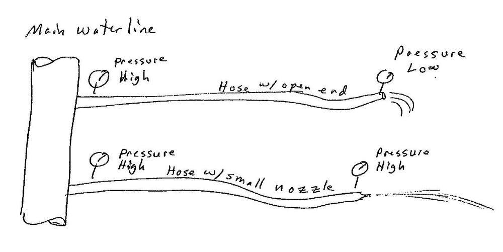

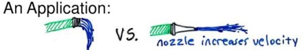

Plumbers and people i talked all said as velocity increases in the water hose nozzle. Pressure increases or how else will the velocity increase. Do you have simple counterarguments using the concept of water nozzle to disprove their wrong assumptions (which i can correct them) and not using from airplane wings?
When you have a hose with the end open, the pressure is high at the beginning of the hose, and low at the open end of the hose. The total flow is high, and the velocity out of the hose is low.
A similar hose with a small nozzle on the end will have lower total flow. Because the flow is less, the pressure drop in the hose is less. Good search terms to learn more are liquid flow line loss. Because the total flow is less, and the pressure high, the pressure into the nozzle is high.
In both cases, the static water pressure after the hose or nozzle is zero. The static pressure is what a pressure gauge measures. Velocity pressure is what you feel when the water flow is aimed at you. The velocity pressure is low with the open hose, and high with the nozzle.
The nozzle changes static pressure into velocity according to the Bernoulli Equation as mentioned above.

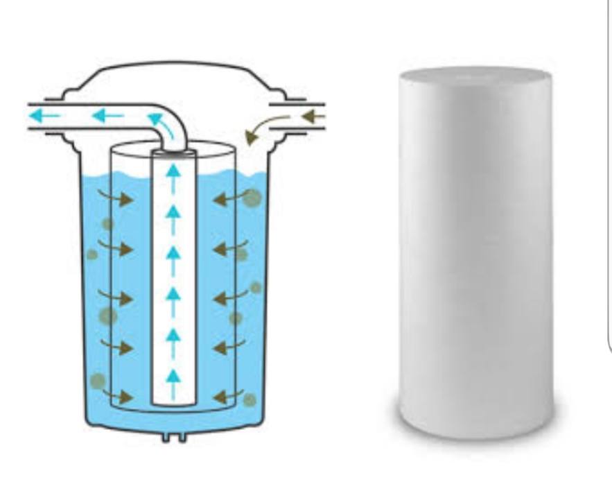

Ok. Thanks a bunch. Are you familiar with sediments filter? They come with flow rate. Does it mean water from the source can pass through them with almost no loss? Is there any turbulence or pressure loss in passing through the sediment filter? Or are sediment filters designed so water can just flow in without hindrance. Or does the flow rate can only be taken advantage if you use a pump?
I bought 3 slim 20"filter housing and filters and thinking whether to get the so called Big Blue twice bigger.
All filters have pressure drop. That pressure drop is a function of flow rate - more flow equals more pressure drop. The pressure drop increases as the filter gets loaded with dirt. If you want more information, good search terms are filter beta ratio and water filter pressure drop.
The flow rating for a home water filter is a number that tells you where to use it. A whole house filter needs a larger flow rating than a filter that's used for a kitchen faucet.

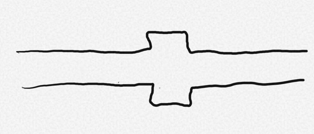

The following is middle of a hose. The water passes by a small enlarged area midway. Will there be turbulence introduced and slight pressure drop?
Yes. There could be a little drop or a lot, depending on velocity, and size and shape of the enlarged area. And there is no easy way to calculate the amount of pressure drop.

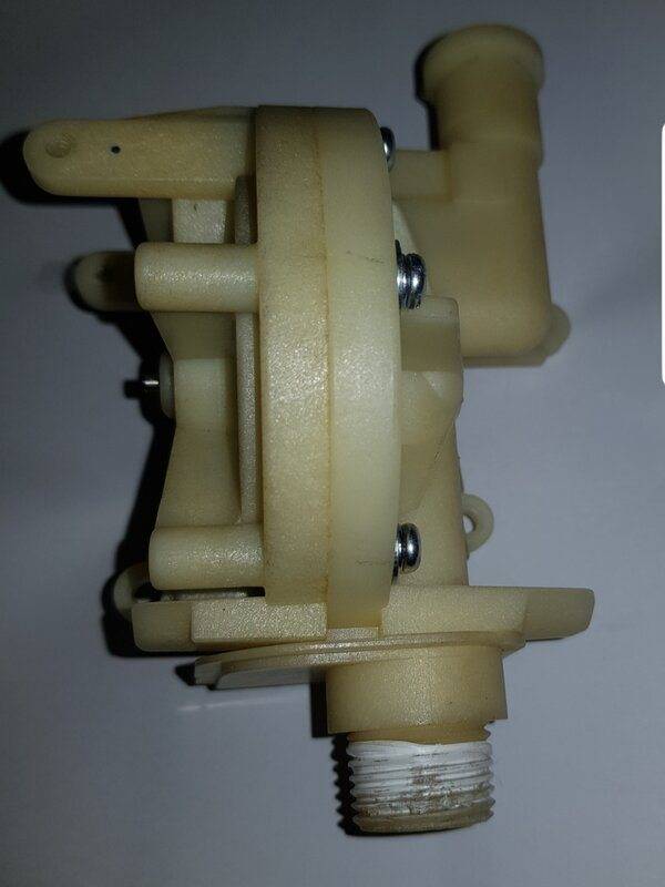

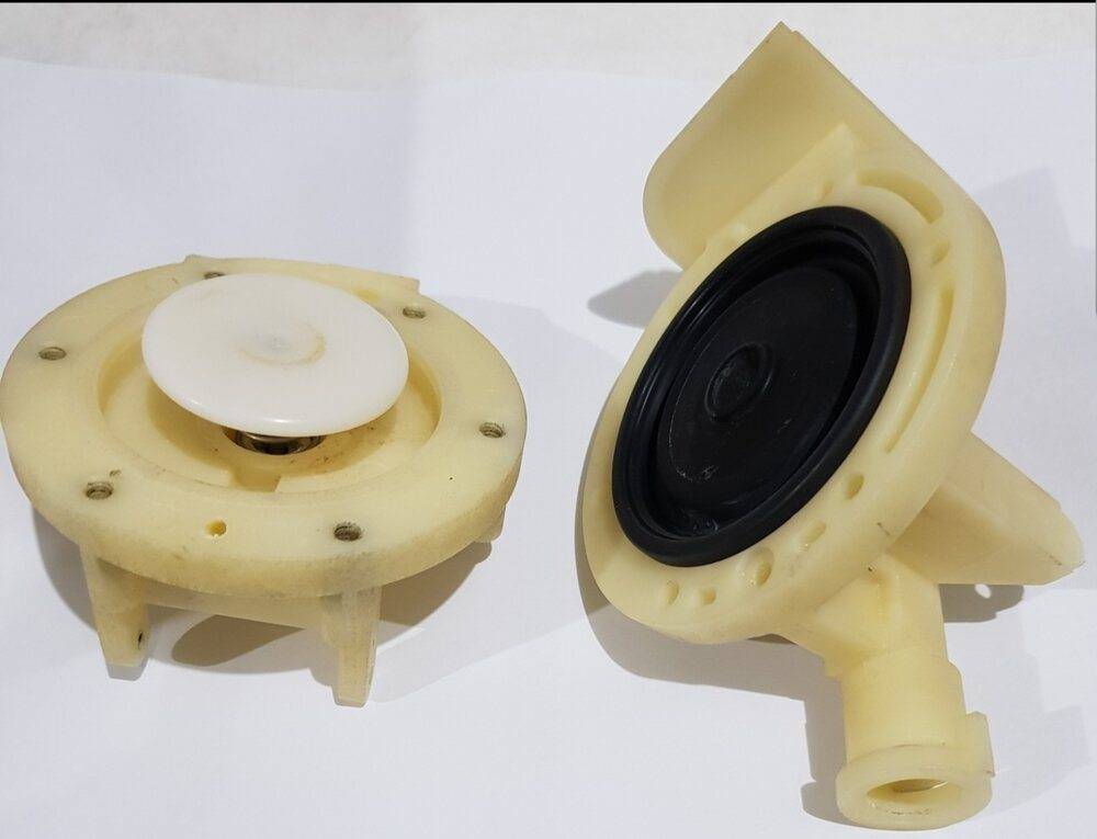

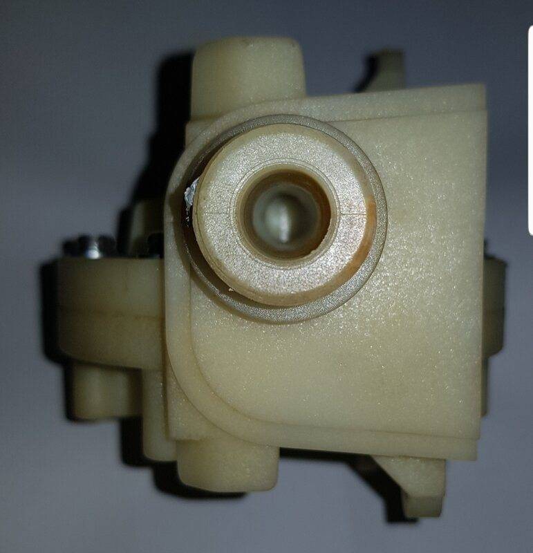

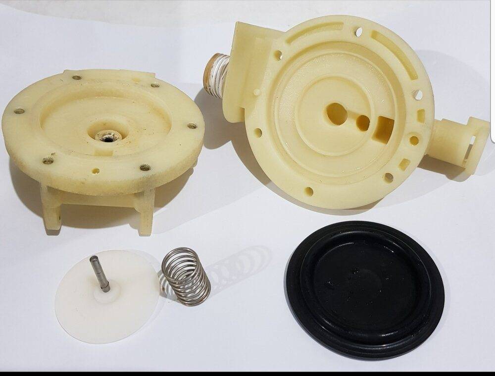

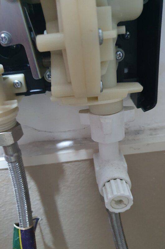

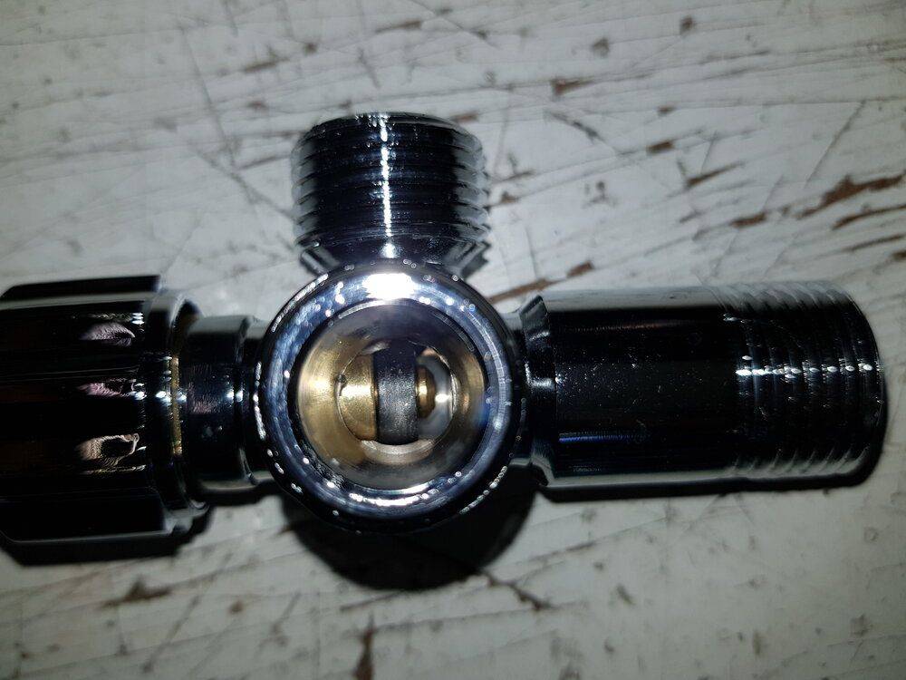

Have you heard of a device that looks like a pressure switch but actually it's a flow strength swtich? That is. In the following, the pin will only move if there is water flow. But if you plug the other end, the pin will return back. In ordinary pressure switch. It's the opposite where without flow, there is maximum pressure and so the pin will extend. In the following without flow, the pin will not extend. Only with flow of certain minimum strength will pin extend. Or know any other device where it is enabled by the flow velocity pressure? Note that water enters here at center. Jet from the center to the nearest hole and exit the other side.
View attachment 269669View attachment 269670View attachment 269671View attachment 269672
To illustrate the above. Here is the great puzzle. In the following youtube video you can see the pin of the flow switch diaphragm extended when the faucet is flowing (the valve is after the flow or pressure switch).
Supposedly in a normal pressure switch. As someone described. The pressure will be a maximum when there's no flow, precisely because at zero flow there is no pressure drop anywhere in the system, so the pressure here will be full mains pressure. When the shower-head is on and there's flow, the pressure here will drop.
But in this flow switch diaphragm. It's the opposite. What is in the design in the diaphragm such that when there is no flow (pressure maximum), pressure won't push the pin. The pin will only extend when there is flow.
Any ideas?
