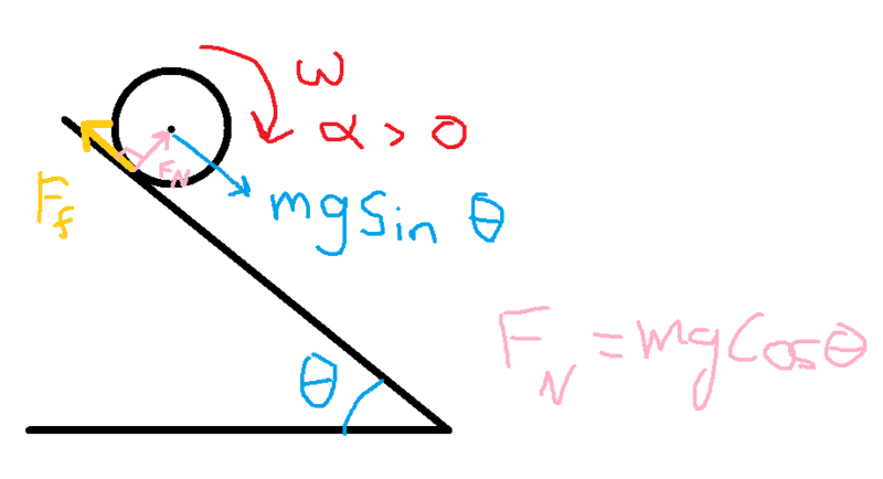

Picture credit of (erobz)
I'm thinking there's a friction force on the cylinder of ##mg \sin \theta## and an equal and opposite force on the ramp, when this force is greater than or equal to ##\mu m g \cos \theta## the wheel will roll instead of side, on rubber against concrete this happens when ##\mu = \frac 1 2## so setting the quantities equal to each other and solving for ##theta## you find ##\frac 1 2 = \tan \theta## so ##\theta = \frac \pi 4## or 45 degrees. Hopefully I'm seeing things clearly!

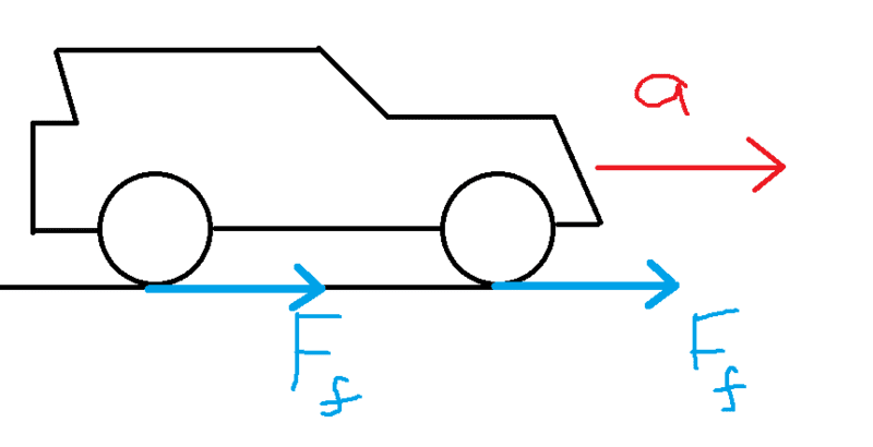

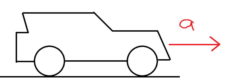

Do you know how friction would work on say a block sliding down the incline?
Or the force of friction on a cars wheels when it is acclerating on a plane surface?
Likes Chenkel
With a block there would be a frictional force of of ##mg \sin \theta## this would be at it's max at 45 degrees if it's a rubber block and a concrete ramp.
With the wheels, assuming the car is on level ground, the maximum frictional force would be ##\mu mg \cos 0## so that would be ##\frac {mg} 2## if we're talking about a compact car, the mass is about 1200 kg, so the maximum friction force would be ##\frac {({1200})({10})} 2 = 6000N## so if the drive force is less than 6000N the wheels will rotate with complete roll... I wonder how much torque that would translate to, it would be interesting to do that calculation.
@Chenkel
No, in both cases. Computing numbers it not what it means to understand how it works.
In particular, what are the direction of the frictional force in the two cases I gave you?
The case of the sliding block, the fricitional force is opposite direction as the blocks velocity
The case of the car that starts to accelerate, the frictional force is in the direction of the acceleration
otherwise, there would be no net force on the car to the right which can cause the car to accelerate
The rolling wheel on an incline, there must be a torque with respect to the center of the wheel in order for the wheel rotatate from 0 angular speed to non zero angular speed, i.e. there must be an angular acceleration
There are two accelerations here, linear acceleration down the incline, the center of mass of that body is moving down the incline faster and faster: ma = mgsinθ - Ff = mgsinθ - μFN = mgsinθ - μmgcosθ.
Rotational acceleration, the object increases its angular velocity around its center, the only force that exerts torque wrt the center is Ff thus we have FfR = μmgcosθR = Iα
Rolling condition, the speed of the center is v = ωR, the acceleration of the center is thus a = αR
Your equations of motion becomes:
1) ma = mgsinθ - μmgcosθ
2 ) μmgcosθR = Ia/R
The object will fail to roll if v > ωR thus a > αR

I believe 2) should be ##\mu m g \cos \theta R = I\alpha## and also the force on the wheels when the car is going forward must rotate it clockwise if the car is going from your left side to your right side, that's a little difficult for me to imagine what's going on there to create that forward driving force.
Chenkel said:
I believe 2) should be μmgcos⁡θR=Iα a
Yes you are right, bad copy paste on my behalf, will fix it

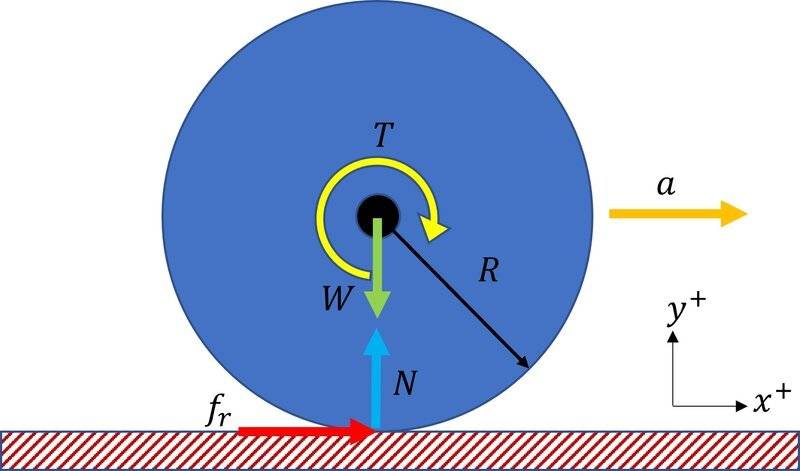

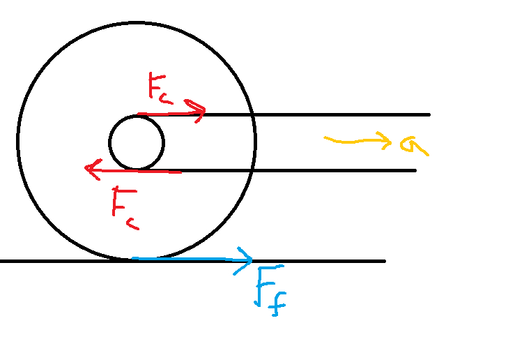

You have torque on the wheels from the engine, you know you have a chain on your bike wheel for a reason? :)
bike accelerating to the right, Fc is force from chain on wheel
As you can see, Fc does not provide a net acceleration on the wheel (force pairs) but instead the net force that cause acceleration comes from the friction force from the ground on the wheel! That is why you can't ride the bike on 100% slippery ice! :D
So, as you can see, the direction of the frictional force on a rolling wheel depends on the situation.
  • Love
Likes Chenkel

So the torque applied by the chain causes a torque, then there's a contact surface area with the ground, the little ridges on the wheel will push from right to left on the ground, and the ridges on the ground will push from left to right on the wheel, pushing the bike forward. The following part is a little hard for me to understand, as the car moves forward the wheel rotates clockwise, because the torque from the chain is greater than the torque from the ground on the wheel, is there something going on here that I'm missing? When can we accelerate the cm of a body with a force when that force could potentially create a torque?
You also have a torque of friction from the axle which the wheel is attached to (and from the chain, that is why you need oil). This is why you need to keep moving those legs in order to keep going (well you also have air resistances as well... but let's ignore that for a while...)
You can also think about such a simple this as walking, if you are walking to the right, what is the direction of the frictional force from the ground on the sole of your feet?
Likes PeroK and Chenkel

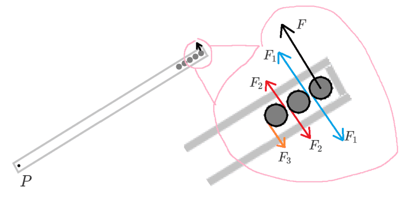

For rotation, all the internal torques cancles out, so only the net external torques cause angular acceleration
Here is a model for that. All the internal torques from the F1, F2, ... force pairs are canceled.

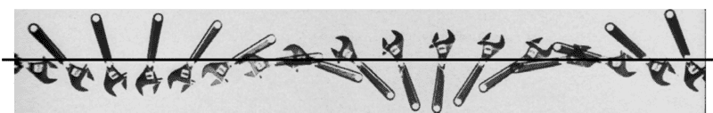

Hmm, I tried pushing my phone around from one end, it seems as long as I'm always force is always perpendicular to the edge the cm will move in a circle (the cm won't stand still) I wonder what's going on.
You are chaning the direction of the force. Just give it a short impuls with a flick of the finger. Also make sure there is not so much friction.
you should be able to see this kind of motion
CM moves in a straight line and the entire pencil is rotating around CM
Is F an external torque? I'm guessing it cancels with something outside the system, and F1 is an internal torque canceling with an internal torque, are these F1 vectors directed along the same line but in opposite directions? It's a little hard for me to tell from the image.

There are several forces on the wheel, both external and internal (the force on the weel from the engine and a force from the wheel to the engine). The net external force is in the direction of the wheels acceleration. Without friction on the wheel, the wheel will just rotate.

It seems it wants to translate and rotate when I give it a flick, I wonder what conditions it wants to 1 rotate, 2 translate, 3 translate and rotate. Also if it translates and rotates, I suppose some of the impulse is translated into torque, and some of the impulse is translated into translation, I wonder what is going on with energy in this situation..

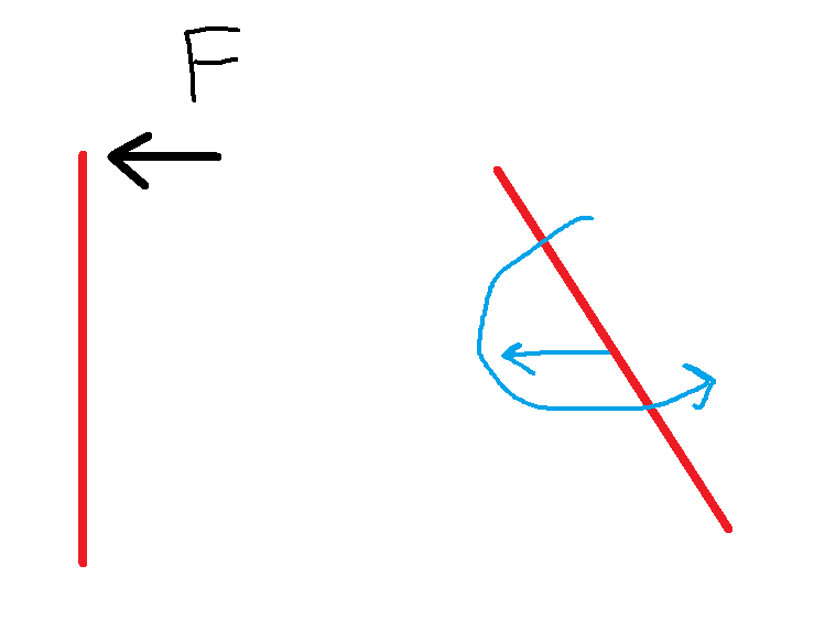

1) it will never just rotate, unless there is a static axis
2) if you flick at the location of the CM
3) if you flick at any point that is not CM

Does a static axis mean that some apparatus allows rotation about the center of mass but prevents translation?
So the energy is turned into kinetic energy either linear, rotational or both, I guess how this happens depends on the moment of inertia and where the force is applied.

Consider the front wheel on a bike as an example.
Likes Chenkel

I'm not trying to hijack Chenkels thread, but maybe someone could help us solve for the acceleration of the following wheel and it would be beneficial to both our understanding?
I'm imagining a constant torque applied to the wheel ##T##. What is the acceleration of the wheel?
$$ \sum F_y = N - mg = 0 \implies N = mg \tag{1} $$
$$ \sum F_x = f_r = ma \tag{2}$$
From ##(1)##:
$$ f_r = \mu mg $$
## \mu## is not a constant with respect to ##a##. I believe it must be the case that if the wheel is not slipping:
$$\mu = \frac{1}{g}a \leq \mu_s\tag{3}$$
Now applying a torque balance about the axis ## \circlearrowright^+##
$$ \sum \tau = T - \mu mg R = I \alpha $$
With no slip : ## \alpha = \frac{a}{R}##
$$T - \mu mg R =I \frac{a}{R} \tag{4}$$
Substitute ##(3) \to (5)##:
$$ \implies a = \frac{T R}{ I + m R^2} $$
We have the condition that ## a \leq \mu_s g ##
Which means for the wheel not to slip:
$$ T \leq \mu_s g \frac{1}{R} \left( I + m r^2 \right)$$
correct?
EDIT:
It seems so be in agreement with what @haruspex gave in for the same geometry.
https://www.physicsforums.com/threads/a-spring-disk-and-pulley-system.1016701/post-6651212
$$ \tau \leq \frac{3}{2}\mu_s N R$$
  • Love
Likes Chenkel
