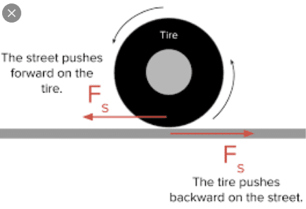

I know it takes friction for a car/wheels to move forward. However, I am confused by the free body diagram.
As a torque is applied to the wheel, the wheel applies a force to the road, and as a reaction, the road puts a force on the wheel(this is friction). Then wouldn't the torque of friction on the wheel(Fs X Radius of wheel) cancel out the torque of the axle on wheel, thus no movement?
I also don't see how the force of friction on the wheel from the road causes it to act at the center of wheel driving it forward.

It doesn't act at the center of the wheel. It acts at the bottom surface of the wheel. If it acted at the center then it would not produce a torque on the wheel, and as we already discussed it clearly does produce a torque.
Dale, I am probably confusing the torque. For right now I am going to ignore that question.
I guess what has me stumped is in my physics book, there is a free body diagram of the car similar to the what I attached above. It shows the only forces acting on the car are its weight and the normal force. These cancel out. And then the force of static friction, which is the reaction to the wheel pushing horizontally back against the ground.
They say it is the friction force from the ground on the wheel that propels the car forward. How? I see the friction force pushing that the bottom of the tire, but it is static friction. The cars tire doesn't move relative to the ground. Yet the entire car moves and accelerates forward.
So my question is how does the friction force pointing in the direction of the cars motion, but it only acts on the bottom of the tire, actually do so?

That's not a free body diagram. A free body diagram shows all of the forces acting on an object only that object. That diagram shows a Newton's 3rd law force pair between the tire and road. A free body diagram would show a torque applied by the axle and a backwards force applied by the shaft bearing. If the forces and torques do not sum to zero, the car (wheel) accelerates.
Think about what happens if instead of a tire, the forces are applied to a stick (or paddle wheel on a boat) in the same configuration. What does the stick do and why?

OK, but lets' simplify it to a single paddle. That's analogous to a canoe paddle. When I paddle my canoe, I move it in a semi-circular motion. Do you have difficulty understanding a canoe?
alkaspeltzar said:
The force is at the bottom of the tire, but the entire car moves forward. how does the force of static friction cause/or translate itself to make the entire car move?
There is no need for the force to translate itself. Regardless of where the force is applied the acceleration of the center of mass of the system is the same.
It appears to me that you have a misunderstanding about Newton’s 2nd law. You seem to be under the impression that a force must be applied at the center of mass in order to accelerate the center of mass. That is not the case. Regardless of where a force is applied it will cause the center of mass to accelerate.
