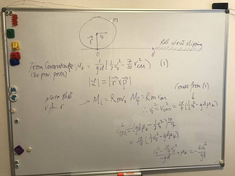

I tried doing the question again. It got a bit confusing. If we use the $$L = I\omega$$ definition of angular momentum, then what is the angular momentum at the beginning where there is no angular velocity. My professor noted on the blackboard that even objects moving linearly has an angular momentum, but he used the $$\vec{L} = \vec{r} \times \vec{p}$$ definition which (without extensive use of vector calculus) can only be used with point masses rather than the sphere of a billiard ball we have here. The only other thing I can think of is to consider the billiard ball as a point mass at the CM and use the vector definition, but I am not sure if I can do that. I tried to do it this way, but got another wrong answer.
That should work. Please post your working.
I have attached a photo of the whiteboard. I can type it in latex in just a moment.
In case the photo isn't clear, here is the latex version.
We have from above: $$\mu_k = \frac{\frac{1}{2}v_0^2-\frac{7}{10}v^2}{gd}$$
Hence, $$v^2 = \frac{10}{7}(\frac{1}{2}v_0^2-gd\mu_k)$$
By Conservation of Angular Momentum, $$|\vec{L}| = |\vec{r}\times\vec{p}|$$ (the norm is there because the direction of the momentum is the same before and after and it simplifies the calculations).
Since ##\vec{v} \perp \vec{r}##, $$L_i = Rmv_0$$ $$L_f = Rmv$$
(Note that the angular momentum is consider relative the point of contact between the wheel and the surface.)
Hence ##v^2 = v_0^2##
Hence, by the second equation in the post $$v_0^2 = \frac{10}{7}(\frac{1}{2}v_0^2-gd\mu_k)$$
Hence $$\mu_k = -4\frac{v_0^2}{14gd}$$
Nonsense. This says that the ball does not slow down. You need to rethink your expression for the angular momentum. Remember that ##L=I_p\omega## where ##I_p## is the moment of inertia about the point you use to calculate the angular momentum.

If I use that definition, I need to know what omega is at the beginning. I was explicitly told that there was no angular velocity at the beginning. I have to somehow convert “linear momentum” into angular momentum. The only way I know how to do that is by using the vector definition of angular momentum. But that does not involve moment of inertia, which is why haruspex suggested that I can consider the ball as a point mass at the CM to avoid trying to reinvent the wheel of integrating over the momentum of each infinitesimal constituent of the ball.

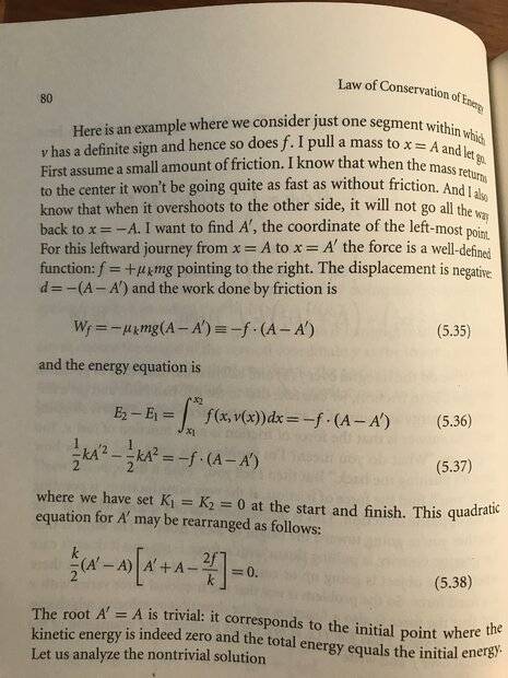

Why is the net work done by friction not zero when something goes from x-1 back to x-1?
You are leaving out the rotational component that is acquired.
Consider a mass element dm at ##\vec r## displacement from the centre of the ball, C.
If the ball is rotating at rate ##\omega## then its velocity relative to C is ##\vec r\times\vec \omega##.
If the ball is at ##\vec r_P## from the axis P and has velocity ##\vec v## then dm is at ##\vec r_P+\vec r## and has velocity ##\vec v+\vec \omega\times\vec r## relative to P.
Its angular momentum about P is therefore ##((\vec r_P+\vec r)\times(\vec v-\vec r\times\vec \omega))dm=(\vec r_P\times\vec v+\vec r\times\vec v-\vec r_P\times(\vec r\times\vec \omega)-\vec r\times(\vec r\times\vec \omega))dm##.
By definition of mass centre, ##\int \vec r\cdot dm=0##, so the middle two terms vanish:
##\vec L=\int (\vec r_P\times\vec v-\vec r\times(\vec r\times\vec \omega))\cdot dm=M\vec r_P\times\vec v-\int \vec r\times(\vec r\times\vec \omega))dm##.
If we break ##\vec r## into components normal and parallel to the rotation, the triple product reduces to ##-r_\perp^2\vec\omega##, hence ##\vec L= M\vec r_P\times\vec v+\int r_\perp^2\cdot dm\vec \omega= M\vec r_P\times\vec v+I\vec \omega##

Because kinetic friction is always opposite to the displacement. The work done by friction is $$W_{\!f}=\mu_k mgd\cos\!\theta=\mu_k mgd\cos(180^{\circ})=-\mu_k mg d.$$ The force and displacement vectors are antiparallel regardless of the direction of the displacement. So, unlike gravity, the round-trip work done by friction is twice the one-way work if you retrace the path exactly.

I have attached a photo of what my textbook says on the matter of friction and the work-energy theorem. This is from Chapter 5 Section 5.4 of the Fundamentals of Physics I. There are probably more context required. But clearly it says that the work done by friction is … and the energy equation is …
Relating the two definitions of angular momentum was another big question I had in my mind after learning this subject. I really appreciate you clearing that up. The derivation was incredibly enlightening. That said, coming back to the problem, to use this conservation law I would have to know what the angular velocity at x=d is (since, as you say, the rotational component is necessary). Since at x=d the ball rolls without slipping and the slippage is a continuous function, knowing the angular velocity is equivalent knowing the linear velocity of the CM at x=d and that, with energy conservation, would give us the answer. To find the angular velocity or the linear velocity, we would have to know the linear acceleration of the CM, the number of radians traveled from x=0 to x=d, or the time it took to go from 0 to d. None of which is easy to compute (at least to me). That, I believe, is where I was stuck on. I do sincerely apologize for taking up so much of your time. I am a bit slow with these things.
