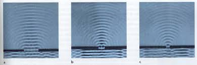

"but the fringes one obtains by applying Huygens principle and interference principle are not present". If you do the full Huygens analysis you get exactly the right answer but, rather than having just one source at each slit in a simple multi slit demonstration, you need an infinite number of sources across a single slit (diffraction, as Dale wrote above). You need to Integrate the effect over the width of the slit.

@Dadface : Those are very nice images but what do they actually show? For a start, they are very near field so they are not Fraunhoffer region because the approximations used in that analysis really do not apply. The patterns are only a few slit widths in extent and the dominant visible features are more related to the drop off in wave energy and transit time than the maxes and mins of the pattern. I would be interested what students would actually have to say if they were asked to describe what they have learned about what is going on and how it relates to the typical diffraction and interference patterns with light.
The OP needs to search with the term Fresnel Interference, which describes the near field. I am not too surprised that the returns on such a search are more aimed at radio wave and light diffraction because there is probably more interest in those fields. Surface / gravity waves are a bit of a minority interest.
To me the images show quite clearly the single slit diffraction pattern one would expect with waves in a ripple tank. In each case there is a central maximum dropping to a minima on each side. The width of the pattern is seen to increase as the width of the gap decreases and subsidiary maxima can also be seen. These show up particularly clearly in diagrams b.

I disagree. The left column of images posted by @Dadface is a good example
Yes. Excellent, in a qualitative way but the rounded off shape of the pattern and the fact that wave amplitude drops off so fast detract from the basic message. You can see a side fringe, either side of the main beam best in the second in from the right and the second in from the left. However, the very basics of diffraction that tell you the pattern from a wide aperture is narrower than from a narrower aperture are not clear because the 'throw' of the beam is so short. In fact, one could easily get it the other way round if not actually instructed about what to see.

I am very happy to see figure b of Dadface. Thank you. In fact I just happen to observe a similar photo in French´s book Oscilations and Waves.
So we must conclude that even in the near field it is just a matter of setting up the parameters correctly (lambda and the slit aperture) in order to observe the interference fringes due to diffraction in water.
