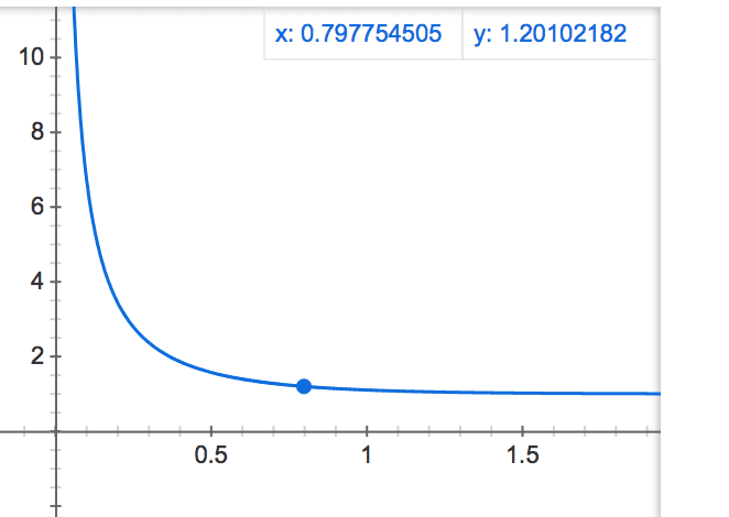

Maybe it is time for a picture. Mathematically speaking, the most basic fact about this simplified version of the cosmos (which gives a remarkably good approximation as long as one does not go back into the early hot radiation-dominated days) is that the expansion rate is tracked by the hyperbolic cotangent function "coth".
$$H(x) = \coth(\frac{3}{2}x)$$
Google graphs hyperbolic trig functions. You can say "graph this" and it will plot a graph. Here is a screen shot of the universe's distance growth rate, with a dot at the present.
The present time is 0.8 zeon.
The eventual growth rate is 1 per zeon. What that means is that, for example, in a thousandth of a zeon each distance grows by a thousandth of its size. By a tenth of a percent in other words. Because the growth rate changes we should think in terms of small intervals of time over which it is approximately constant. Unit growth rate means that in a millionth of a zeon a distance will grow by a millionth of its current size.
(If you like referring back to years, a millionth of a zeon is 17,300 years.)
Anyway that is the unit growth rate we are using and it is also, as you can see from the graph, the eventual expansion rate that the universe is approaching. It is interesting how astronomers measure this. We could discuss this later on.
You can see that at the present time, 0.8 zeon, the growth rate is 1.2 per zeon so it is still some 20% larger than the longterm limit and has a ways to come down.
For comparison, if you go back in time, say to time 0.1 zeon, the curve rises sharply. At a tenth zeon, the growth rate was 6.7 per zeon, or seven times the longterm limiting Hubble rate (which we call H).

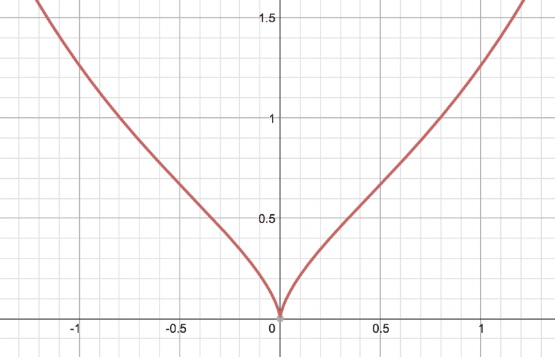

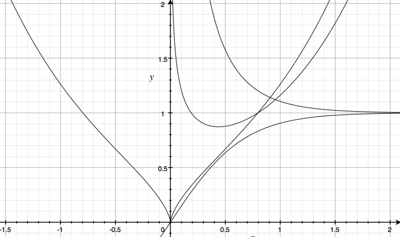

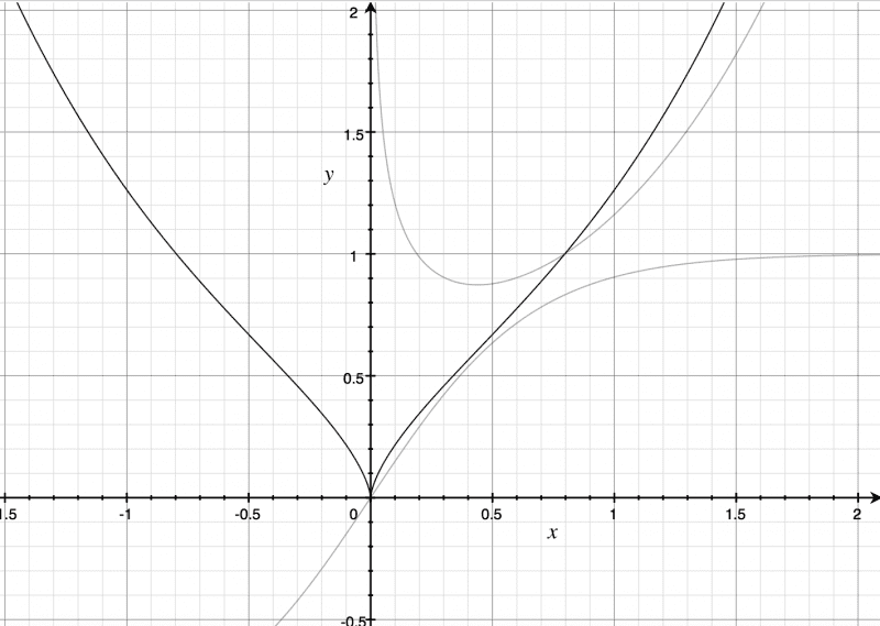

Another thing that happens is that we can solve for a typical distance growth history u(x).
Whatever the curve u(x) is, it has to have its fractional growth rate u'(x)/u(x) equal to H(x). This determines u(x) uniquely up to a multiplicative constant. So we get $$u(x) = \sinh^{2/3}(\frac{3}{2}x)$$
This gives the basic shape of all distance growth histories, but it contains no information about the present. We can multiply it by the cube root of 0.443 to normalize it, so that it will equal 1 at present. This then becomes the normalized scale factor a(x) familiar to many of us. 1/a(x) = s(x) shows how the stretch factor evolves as a function of time. Here's a plot of a(x).

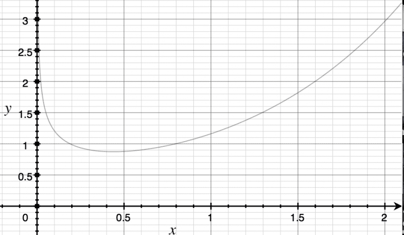

The slope of a(x) is an indicator of expansion speed as distinct from growth rate. The speed the size of some particular distance was increasing.
Speed is not a good handle on expansion because it is somewhat arbitrary, depending not only on the RATE H(x) but also on the size the particular distance being studied happens to be at the moment. Also distance expansion is not like ordinary motion--nobody gets anywhere by it, everybody just becomes further apart. So it is confusing to picture it as a conventional motion with the usual sort of speed. However some people are interested in distance expansion speeds, and we can see how they change over time from this plot. The expansion speed of our sample distance DECREASES until around time x = 0.45 zeon. And then a gradual acceleration begins---the slope of the a(x) curve begins to steepen. The shape turns from convex to concave around that time.
In plotting this curve I divided by 1.311 to normalize the hyperbolic trig function u(x). This amounts to the same thing as multiplying by the cube root of 0.443 but avoids some round-off error. The changeover from deceleration to acceleration is subtle but you will see that it happens around time 0.45 zeon.
It happens when the decline in H(x) levels out enough. As long as the downwards slope of the H(x) = coth(1.5x) curve (shown in post #4) is steep enough the speed that a(x) is growing lessens. Around x = 0.45 zeon the H(x) growth rate curve is still declining of course---it always declines---but the slope is sufficiently less steep, and then a(x) switches over to acceleration.

I'm glad you are OK with the term "zeon" (as long as not abbreviated)! I think we are talking about the same numbers. Indeed it would be possible to replace 0.443s3
by (s/1.311)3
and s/1.311 has a physical interpretation as the reciprocal of the unnormalized scale factor
u(x) = 1.311a(x) = sinh2/3(1.5x)
I guess you could say that 1.311 is how big the universe thinks it is at the present moment :smile:,
namely u(xnow). I think that may be what you were referring to when you mentioned a "natural stretch scale". u(x) is suggestive of a "natural scale factor". And stretch and scale-factor are reciprocals.

It could help finalize it. That's a nice offer. I thought of another subtopic, plotting the expansion speed of a selected distance.
The distance chosen for this example (here as in the Lightcone calculator column menu) is one whose current size coincides with the present-day Hubble distance. Since Hnow = 1.2014 per zeon, the Hubble distance is currently 1/1.2014 lightzeon.
Here is the sample speed history:
You can see that it is expanding exactly at the speed of light at the present moment (x = 0.8) which is right because that defines the present-day Hubble distance.
And it has its speed minimum around the time x = 0.45. That is where the inflection point comes in the a(x) scale factor curve, when deceleration changes to acceleration. All distances' speed curves look the same, they just differ by a multiplicative factor--they are proportionate to the size of the distance.
Using this model, the size history of that particular distance size(x) = a(x)/1.201 lightzeon
and have the formula for the normalized scale factor a(x) = sinh2/3(1.5x)/1.311
Then its speed history is simply the size multiplied by H(x) = coth(1.5x).
So the expansion speed of that particular distance is:
speed(x) = H(x)size(x) = coth(1.5x)sinh2/3(1.5x)/(1.311*1.201)
So that is what is plotted here.
I see that by time 2 zeon that particular distance will be growing at 3 times speed of light. It was also growing at over the speed of light until 0.2 zeon, but between that time and the present 0.8 zeon its expansiopn speed was less than c.
