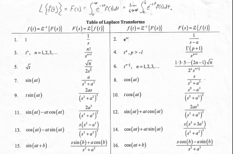

Bit of a long one, here we go!
The water level equation is known to be:
##\frac {dH}{dt} = (F_{in} Voltage - F_{out} \sqrt {H}) \frac {1}{A}##
whilst the temperature equation is known to be:
##\frac {dT}{dt} = \frac {(F_{in} Voltage)(T_{in}-T)}{Volume} + \frac {Q}{Volume*\rho*C_p} ##
where:
H and T are OUTPUTS;
Voltage is the INPUT;
T_in. F_in, F_out, rho, Cp, Q are parameters;
The target is to find the Transfer Functions G and H respectively, where $$ \text{transfer function, G or H} = \frac {\text{Laplace transform of Output}}{\text {Laplace transform of Input}} = \frac {\theta_o}{\theta_i}$$
After getting the Laplace transforms, substituting all the differential operators with the Laplace operator s to simplify, I cannot manage to find algebraically a Transfer function.
1st equation: $$ AsH_{(s)} + F_{out} \sqrt {H} = (F_{in} Voltage)$$ the problem is the square rooted H, which does not let me factorize the H to achieve an equation of the form ## G = \frac {H_{(s)}}{Voltage}##. I tried achieving it by squaring, thus obtaining a quadratic equation, but finding the roots of H didnt work.
2nd equation: $$s{T_{(s)} + \frac {(F_{in} Voltage)T_{(s)}}{Volume}}= \frac {(F_{in} Voltage)T_{in}}{Volume} + \frac {Q}{Volume*\rho*C_p} $$ the problem is the voltage being on both numerator and denominator of the right hand sign when I factorize the T, therefore being unable to factorize Voltage and get a transfer function in terms of s and parameters only, Voltage is an amplifier and independent variable. Much like the first, am trying to find an equation of the form ## H = \frac {T_{(s)}}{Voltage}##
If you read this far you're a trooper, thank you for any help!

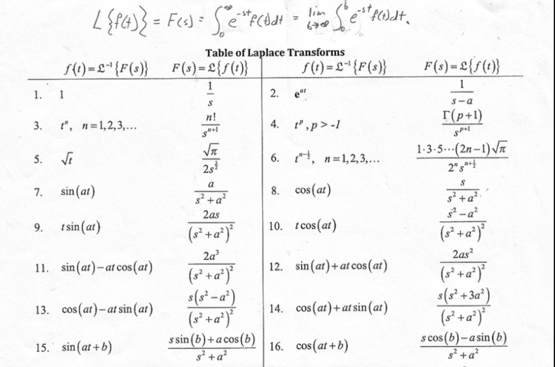

honestly i am confused about her mention of the volt units as well lol, coming from a physics background i am not used to that concept.. The m^2.5 of Flow_out i am also unsure although that si the info I have been given in the HW, when i analyse the units i do find that they seem to match on both sides though, as long as the Voltage is considered without units, for some reason, I'll ask her about this.
ANYYWAYY, i tried carrying the ##\sqrt{H}## on the left side and taking the Laplace transform of both H terms. I have looked at a Laplace transform table for the conversions and have come up with the following:
$$\frac{dH}{dt} = \frac{F_{in}\text{Voltage}-F_{out}\sqrt{H}}{\text{Volume}}$$
$$\frac{dH}{dt} + \frac{F_{out}\sqrt{H}}{Volume}= \frac{F_{in}\text{Voltage}}{\text{Volume}}$$
Laplace transform:
$$sH + k_o\frac{\sqrt{\pi}}{2s^{\frac{3}{2}}}=k_i \frac{1}{s}$$
where: $$\text{INPUT}, V= \frac{1}{s}$$, $$k_o = \frac{F_{out}}{\text{Volume}}$$ and
$$ k_i=\frac{F_{in}}{\text{Volume}}$$
Therefore:
$$G = \frac{sH + k_o\frac{\sqrt{\pi}}{2s^{\frac{3}{2}}}}{\frac{1}{s}}=k_i$$
$$G = s^2H + k_o\frac{\sqrt{\pi}}{2s^{\frac{2}{2}}}=k_i$$
$$G = s^2H =k_i- k_o\frac{\sqrt{\pi}}{2s}$$
Which ultimately becomes:
$$G=s^2H=\frac{k}{s}$$ where $$k= \frac{1}{\text{Volume}}(F_{in}-F_{out})\frac{\sqrt{\pi}}{2}=0.2186$$
image source: https://www.bitdrivencircuits.com/Math_Physics/laplace.html
