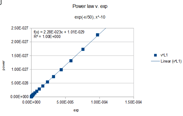

One thing this thread has shown me is how hard it can be to discriminate between an exponential and a power law just based on the data.naviakam said:Yes.
There are many other data sets best fitted with either power law or exponential, therefore ##Y=P(p)Y1(E)+(1−P(p))Y2(E)## still holds.haruspex said:One thing this thread has shown me is how hard it can be to discriminate between an exponential and a power law just based on the data.
I went back to your data in post #43 and found very good fits for both types. So I plotted the one against the other over the range of the x values, 460 to 1026. I.e. yexp against ypow where:
##y_{exp}=e^{-\frac x{50}}## and ##y_{pow}=x^{-10}##.
The graph is an excellent fit to ##y_{pow}=2.28*10^{-23}y_{exp}+1.01*10^{-29}##. I found this very hard to believe, but I cannot see any errors in my work.
Of course, it could not remain so straight as x approaches zero since ypow would shoot off to infinity.
I strongly suspect a general principle here, but I haven't figured out the details. Probably something to do with which terms in the expansion of e-λx dominate for a given x.From this I suggest that you should treat all sets of data as being of the same type, either power or exp, and see which fits better overall.
I have to agree that for the data in post #57 power law looks more persuasive than exponential, so maybe take all as being power.Edit:
Tried other powers, an x range of 500 to 1000, and observed a general behaviour that ##x^{-n}## v. ##e^{-knx}## is a pretty straight line where k=0.00128 and n ranges from 4 to 12. But if I change the range of x (still over an octave) it breaks down quite fast; probably need k to be a function of a, where the x range is a to 2a.

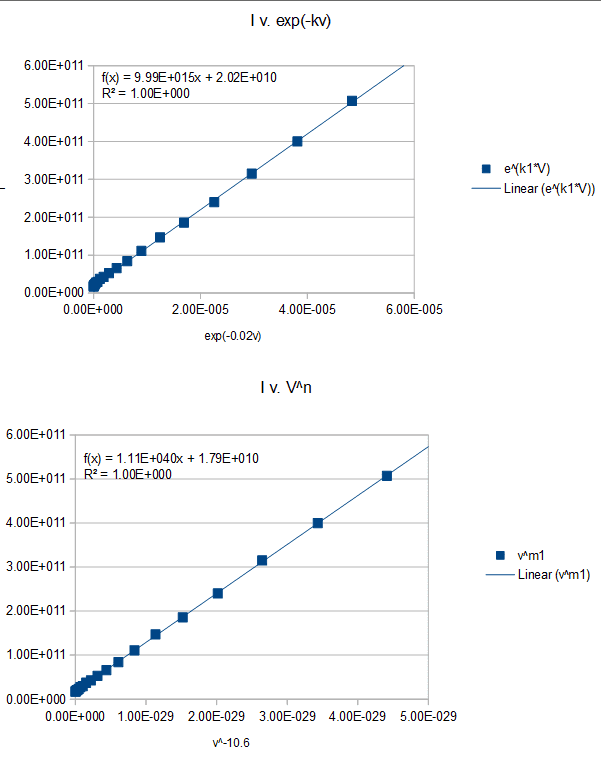

Again, I get a tolerable fit with either exp or power:naviakam said:This is another data fits well with Exp:

haruspex said:Again, I get a tolerable fit with either exp or power:
I slightly prefer the power fit; it seems to have less of a twist near the origin.
One of the tricky parts about fitting curves to data is that the best fit depends on what you choose to plot against what. E.g. the best least squares fit for ##y=Ae^{kx}## will be different from the best for ##\ln(y)=\ln(A)+kx##. The latter model will put more emphasis on the match for the smaller values of y.
To optimise this, it helps if you have some idea how the accuracy of the measurements varies across the range.
