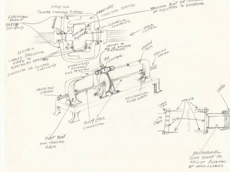

RonL said:His numbers in general helped me to think about where to start, in the evaluation of my machine.
Waiting for berkeman to give me some guidance

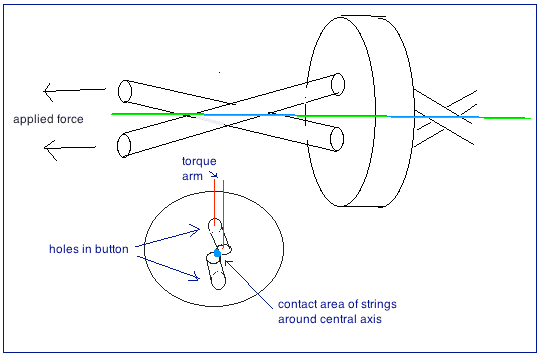

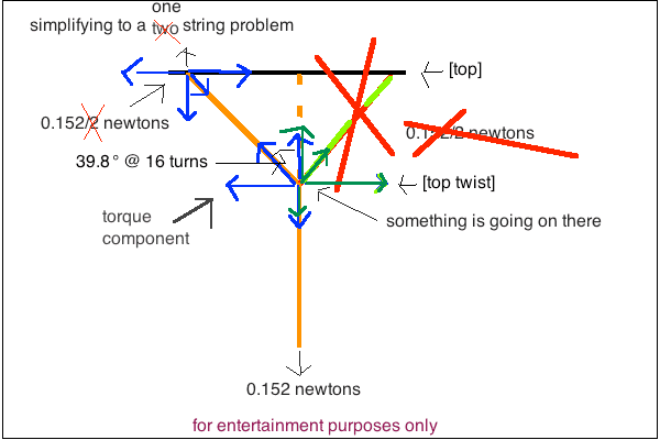

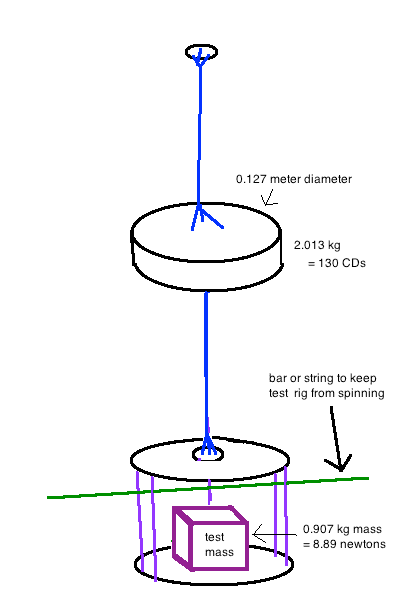

While we are waiting for berkeman to beat us like ugly stepchildren, I thought I'd share a doodle of a kind of free body diagram I just whipped up:
This image may, or may not, display all of the forces involved.
ps. From my recollection of college physics classes, this device was never used as a homework problem in my textbook, and I'm starting to understand why.
