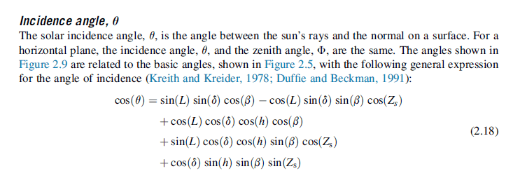

So, at home I have a weatherstation which measures solar irradiation in the east, south and west in lux. I can read in these measured sensordata. From these measurements, I would like to calculate the solar irradiance on my windows. The solar energy formulas could help me with that. The work of Soteris A. Kalogirou explains these phenomens in Chapter two (see http://1.droppdf.com/files/AvIdq/solar-energy-engineering-processes-and-systems-2nd-ed-2014-.pdf).

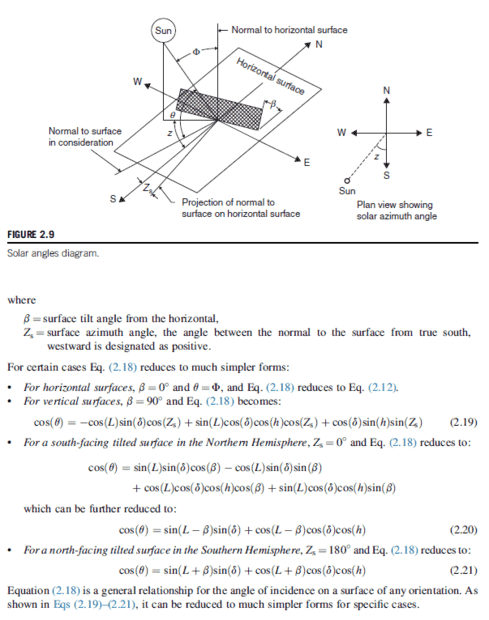

So for example, I have a window which (which has a slope of 90°, vertical) is oriented 20° from the south (clockwise is positive). I know what the incidence angle is and I know that I should use the formule for 'Total radiation on tilted surfaces' which is explained on page 100-101 in the pdf. Starting from the total irradiation in the east, south and west known from my weatherstation, does someone know how to use these measurements to calculate the total irradiance on my window in W/m²?

I will try that as a validation of my estimation. Somehow, I'm convinced that with the measured total radiation in the three orientations, I could convert these to a total radiation on a window in any orientation. Well maybe not the total radiation, but rather the beam radiation as I suppose the diffuse and ground-reflected solar radiation to be zero. The following formulas should do it i think considering I know every concerned angle.
