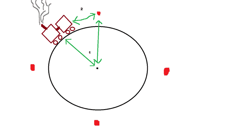

So i thought about some other stuff and then somehow this idea appeared to me, now according to physics it is impossible to communicate information faster than the speed of light through vacuum which is "c".
So for any two bodies moving in opposite directions with great speed so that the total sum of the speeds exceeds c it would be impossible to send EM radio signals between the bodies as he signals could not reach the other traveling body.
So please look at this thought experiment, what happens if we have say a train but instead of traveling in a straight line it would travel in a circle, as it travels around the circle there are 4 stations set 90 degrees apart, say the train somehow manages to travel faster than c with respect to an observer located at either of those stations as the train passes them by, the observer wants to send a direct radio message to the train (assuming there is vacuum) but since the train ravels faster than c the radio signal can't reach the train, so the observer sends the radio signal to the center point of the circle which has a certain radius to the observer and has a radio station located in it. from center the signal gets redirected to the train, and the train can respond back via the same path through the center,since the train is always a fixed distance (radius) away from the center point and so is the observer then given those distance are not very long they will be easily traveled by the radio signal traveling at c, so even though the observer can't reach the train for those 180 degrees from the point where it passes the observer to the point where the train crosses the midpoint, redirecting through the middle can solve this problem.
Please see the attached image,
my question is this does this is a violation of the FTL rule or does this not count because the two observers are not traveling on a straight line in opposite directions ?

Do you know how velocities add in special relativity?

There's another problem here. The train is moving in a circle so acceleration is involved. SR doesn't cover that situation.

In my reference frame - the reference frame in which I am at rest - nothing can move faster than the speed of light. The same is true in your reference frame. So even if some observer sees you and I traveling away from each other at more than the speed of light, then in my reference frame, you are still moving away from me at less than the speed of light.
The speed of light c is the same in all reference frames. If you send me a message at the speed of light, then even in the frame of the observer, it will travel at the speed of light, not at c - vyou. A message you send me by radio or laser will reach me, and if you appear to me to be a distance ##d## away when you send it, then it will take time ##t=\frac d c## to reach me.
This is very counter-intuitive, I know.

This is not correct. If A is moving to the left at .9c relative to me and B is moving to the right relative to me at .9c, A and B will not be moving at 1.8c relative to one another - their relative speed will be something less than c. Thus, I will find that a light signal from A and moving at c relative to me will eventually catch up with B; and A and B will agree. For more on how this works and why the relative speed is not 1.8c you should google for "relativistic velocity addition".
... So please look at this thought experiment,
In your thought experiment no information is moving faster than c. There's a point where the message is sent and a point where the message is received, there's a time when the message is sent and a time when the message is received. We calculate the ditance between those two points, we calculate the travel time, we divide one into the other to get the speed, and we come up with something less than c.
A more precise way of stating the "cannot communicate faster than light rule" would be to say that event at which a message is transmitted and the event at which it is received cannot be "spacelike-separated" - that's another good Google search.

Their speeds in some reference frame added together may be anything up to almost 2c, true, but this does not have the implication you seem to think. The most obvious way to see this is to imagine each ship emitting a pulse of light, which will slowly pull ahead of each ship. It's true that practical communication is difficult because the ship will arrive very shortly after the radio signal, so it's seldom worth replying - the ship will have reached me before I finish spell-checking. But it's possible.
Additionally, if we switch to the rest frame of one of the ships then that ship is at rest (by definition) and it's obvious that light gets ahead of it. Obviously the other ship is moving even nearer c (although never above c - speeds don't add linearly) so the time available to reply is still really short. But it's still possible in principle.

I don't understand why you think this involves faster than light communication. You're using light to do it...

Ok i see your main concern with this, the fact that I mistakenly said that two bodies traveling in opposite directions each having a speed near c cannot communicate with one another, well true normally they can because as you said light travels at c in every frame, but the reason i made this incorrect statement was because I was thinking in cosmic scale, and it is true that for objects separated by a distance long enough and adding the space expansion fact after certain distances oppositely moving observers cannot communicate anymore because the distance between them is expanding faster than c, correct?Now let's apply this to my diagram I am not trying to say I am correct rather I am trying to make sure that either I am correct or wrong.
Now let's say our circular train track is not small but rather large, say as large as the outer diameter of our solar system or larger, everything else is kept the same.
Now surely I could say the train is traveling at 1.5c along the tracks and so from the point of an observer standing in one of the stations the train would pass away faster than c right? And you would say that this is impossible and you would be correct, but as we know our space expands and so the bodies contained within it travel apart faster then c because they sort of "ride" the expanding space much like a surfer rides a wave and the surfers total speed is his own plus that of the wave right?
so what if we have several train tracks on top of one another in our circular loop, and let's say that each of our tracks is moving at 0.5c speed , simply like ball bearing rims travelings around, and let's say that our train located on the top tracks is also traveling at some 0.5c so that means that the total speed of the train with respect to an observer at one of the stations is the sum of all the individual track speeds + the speed of the train itself which would then account over c, so what happens now? the observer sends a radio signal directly to the passing train does the signal catch the train or have we achieved the "expanding spacetime" situation? but he can always send the signal through the center which always has a fixed length and so the signal would get through in that way but not in a direct way?
I hope you follow my analogy of the several co-moving train tracks and expanding spacetime.

That's invisibly small on the kind of scale you need for cosmological expansion to come into play.

Velocities do not add linearly. The correction is minuscule at every day speeds, but extremely significant at relativistic speeds. Your topmost train does not exceed c relative to anything local, such as the track.

No. Look up "relativistic velocity addition".

You don't appear to be reading the answers you are getting. No, there is no such frame. Look up "relativistic velocity addition", as I suggested in my last post.

Note that there's a typo in @sweet springs formula - it should read $$ u=\frac{v+u'}{1+vu'/c^2}$$It's fairly easy to show that requiring ##u>c## leads to the implication that either ##u'>c## or ##v>c##. Also, it's easy to see that if both ##u'## and ##v## are much smaller than ##c## then the denominator is very close to 1 and the formula reduces to the familiar Newtonian form.

The velocities combine in some way, but addition is not the right way to combine them. What you can do is define a parameter ##\theta## such that $$\tanh \theta=\frac{v}{c}.$$ The correct way to combine ##\theta##'s is to add them. But addition is not the correct way to combine ##v##'s.
