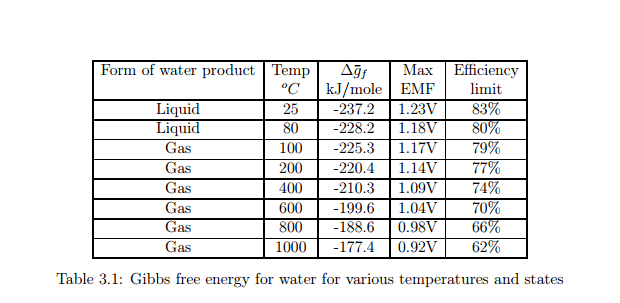

I know theoretically fuel cell efficiency decreases as temperature increases. But in practice it is vice versa. What is the reason of that? I couldn't find enough sources. Any kind of help is much appreciated.
Source?
Even though a fuel cell is more efficient at lower temperatures as shown in Table 3.1, the voltage losses are much less in higher temperature fuel cells. Therefore, it is more advantageous to run a fuel cell at a higher temperature yet lower efficiency to produce higher operating voltages.
Source: Chris Rayment Scott Sherwin Department of Aerospace and Mechanical Engineering University of Notre Dame Notre Dame, IN 46556, U.S.A. May 2, 2003
Enough?...
