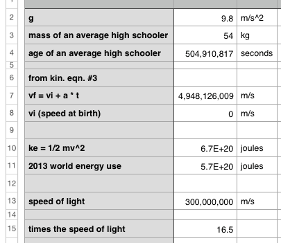

For instance, they claim gravity is caused by the Earth accelerating. (Cavendish was obviously an early "round earth" conspirator)
Here's a rather naive, back of the hand calculation, that shows that the energy to accelerate an average high school student from birth to the speed they're at now exceeds the total world energy consumption for a year. I say naive, as, if you look closely at lines 7, 13, and 15, they are exceeding the speed of light. Perhaps you can have your student correct my maths.
