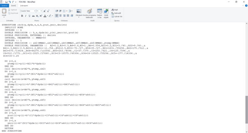

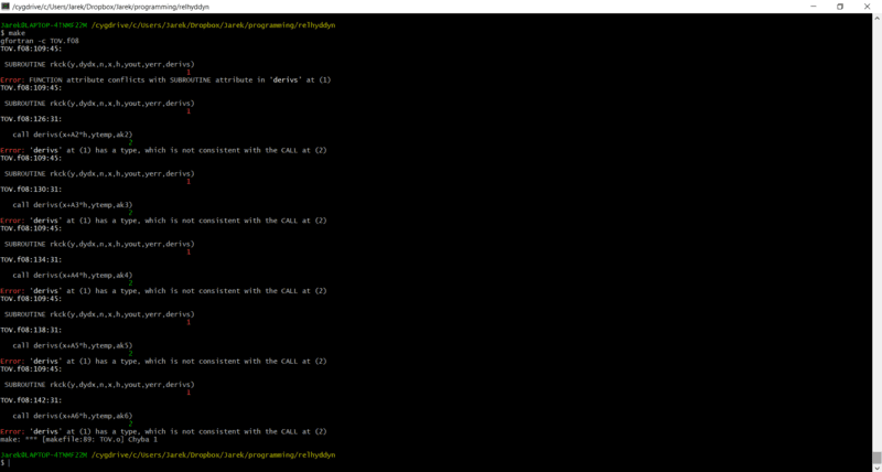

Hello, I'm trying to use Runge Kutta with adaptive stepsize from numerical recipes(page 742, https://websites.pmc.ucsc.edu/~fnimmo/eart290c_17/NumericalRecipesinF77.pdf ). I rewrote code but I have got failure messages both in an attachment. If I cut this subroutine everything is fine also this failure are independent on a definition of function 'derivs' which is causing the problem in calling.
Thank you for any advice.

Your first image is too small to read. Looking at the second one, in rkck the declaration
Fortran:
double precision, external :: derivs
would be valid for a function, not a subroutine. it should be simply
Fortran:
external :: derivs
Fortran:
Fortran:
external :: derivs
Good to know,
Thank you! SOLVED
